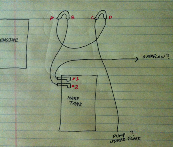

amsugg wrote:
instead of rigging it why don't you just take the time and re plum you system. that's what I did. its not that hard, you don't have to go to the extent I did you can basically just switch a few lines
if you can make a drawing in paint of your set up I can help you buy changing it so you know exactly what to do. I just don't remember how it came from factory
Drawing below of original set-up.
When I added the bags I unhooked 'A' and hooked it to the top of the ballast bag.
I then unhooked 'B', trimmed it down some and hooked it to the bottom of the ballast bag.
I did purchase a short section of hose and some valves and now I just unhook the top and bottom of bag and connect them together. Would love to maybe put in some valves where I can just redirect the flow.
