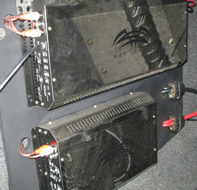

First pic shows SP3 amps with RCA cables.

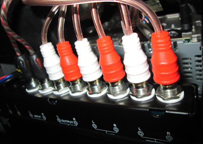

Second pic is of the WS420SQ and the RCA's from the amps plugging into the EQ. Also have one more set of RCA going to back of radio. Pics 2 and 3.

File comment: SP3 amps and RCA's
File comment: RCA's from amps plugging into EQ

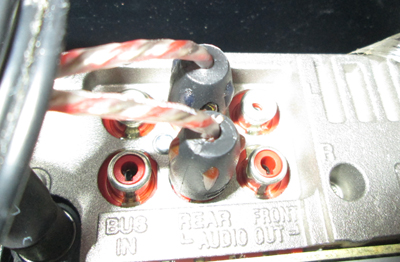

File comment: RCA from EQ to radio

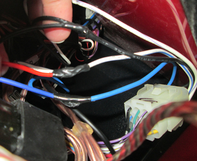

This is the power wiring.
From EQ you will have a Red, Blue, and Black.
From my radio I have a group of wires running into a white plastic connector as seen in pic.
The Black from EQ is spliced into the Black from Clip.
The Red from EQ is spliced into the White with a Blue Stripe from Clip.
The Blue from EQ is spliced into the Blue from Clip.
Hope this helps.
File comment: Wiring from EQ to Radio Power
