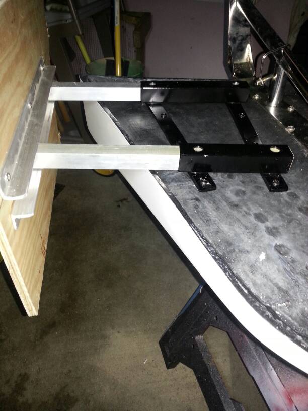

So I modified my redneck surf gate ....... I changed the angle the paddle sticks out (changed front cut from 1 3/4 to 1 1/4) and removed the angled cut from the paddle( paddle is verticle instead of at an angle.) Change to the wake was positive before with original cuts it was a bit soft on top with a strong push in the wake troff length was decent but you had to really know how to pump if you got to far back. New cuts wave is firm from top to bottom, with great push in close and still strong a little further out of the pocket. Makes me really want to try different ideas

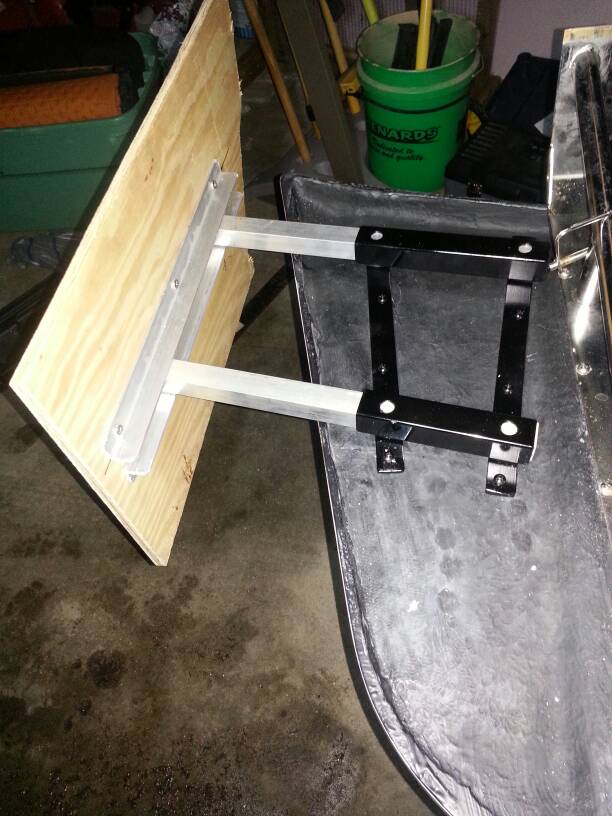

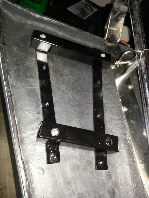

Posts: 272
Here is the one I made for my weekend at the cabin. I started it at a pretty sharp angle because I just have to cut the back pole shorter to adjust the angle in.
For the first time we have been able to surf without the rope with just my wife and I in the boat. I had to soften the angle once already because steering sucked. I cut an inch off the back pole and it was better but I will probably end up making level with the outside of the hull so steering is better.
