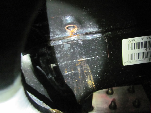

File comment: At the top of the oil pan rail in the center of the engine you will see one brass 1/4 inch pipe thread plug, use a 9/16 wrench or socket and remove the plugs from each side of the engine

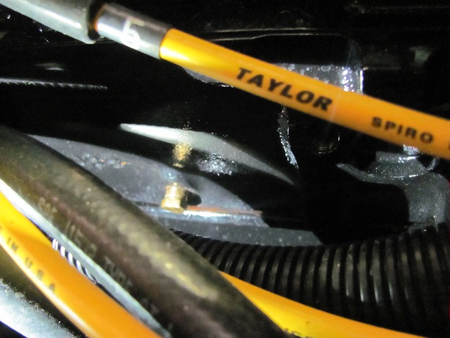

these are the most important plugs to remove by far, if you dont drain the engine block and have a freeze you can usually count on needing a new engine block, and they don't come cheap, The water in there will freeze and crack your cylinder liners, do not skip any steps, do them in any order but just make sure to do them. Be sure to remove the plug on both sides of the engine, one does not drain both sides, the water jackets will hold nearly a gallon individually per side
File comment: The passenger side may be a bit harder to see due to the blower hose being right below the exhaust but use a flashlight and you will see it easily

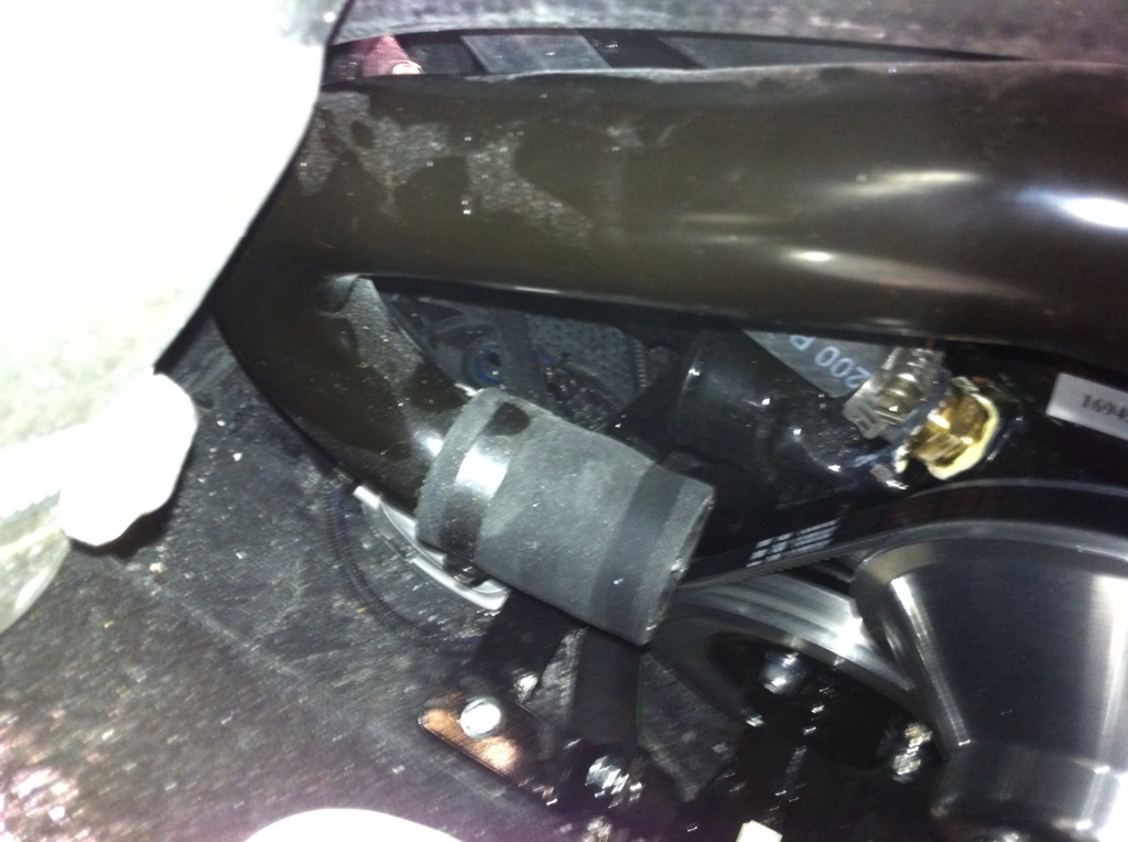

File comment: loosen the hose clamp and remove the lower hose on this cooler, this hose is the main water inlet to the engine coming from the sea water pump and it will hold water in it that can freeze and damage the cooler, push the hose down toward the floor to get all of the water out of the hose

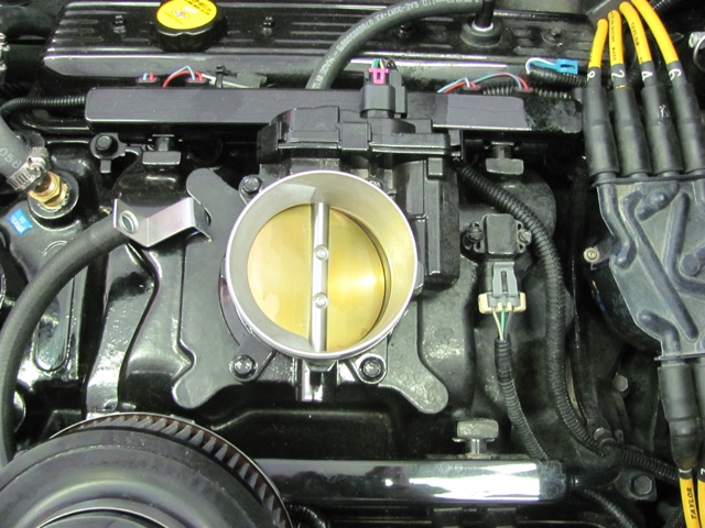

File comment: remove the air filter and unplug the ignition coil, have someone crank the engine for about ten seconds and spray the fogging oil into the throttle body, button everything back up and your done
