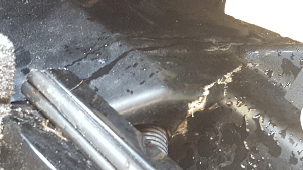

I lift up the transmission cover box and on the left side there is a rather large crack. Its in front of the left side motor mount.
Anybody else have this? just checking ........

Similar looking , however that one is in the bow. Mine is aft , left side in front of motor....Likely will have to ship this back to manufacturer.

Get with dealer and Malibu. They'll make it right. Malibu/Axis built a new hull for me and my dealer gave me a loaner while it was in TN. My original boat had the stringers detach from the entir bottom of the hull. It cracked up and sounded like a drum.
New boat was great.

Malibu says bring it to dealer for inspection, dealer says drop it off maybe we can look at it in a couple of weeks....
Boat industry is pretty arrogant if this is normal.

Your dealer is a real problem. Tommy's Florida handled mine so professionally. They inspected it on the spot with me and sent it to a local fiberglass expert who did inspection, took photos and did a report. Dealer coordinated with Malibu and the boat was sent on to Tennessee factory where they decided to build a new hull. I had a conference call with factory manager and my dealer that really set the tone for a positive result. It was about two/three weeks here coordinating the warranty claim, I was still using it on weekends. Tommy's sent it up and it was at factory for 2 months. I was given an LSV for whole time it was in Tennessee. Truly world class service.
Malibu team called me every week with an update and their QA guy did a great job getting her back to me better than new. In the end I was very happy, although, if you read my thread (Spider Cracks) from last year, I was freaking out about it during the process. I love my boat and hated that it happened.
Tommy's made all the difference. Obviously Tommy's is a well respected dealer and Malibu treated me well as a result of their support.
