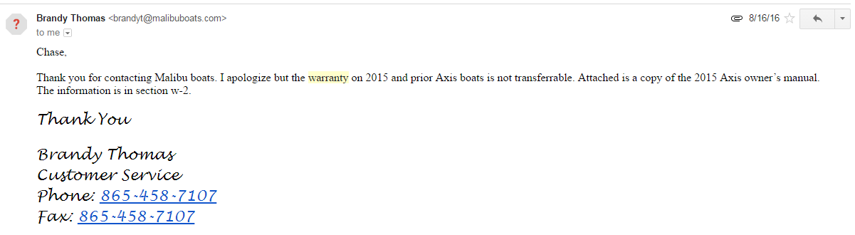

As far as warranty, see the attached email. Does not transfer.
2017-04-07 13_02_54-RE_ Axis Contact Us Request - chaserummans@gmail.com - Gmail.png
2017-04-07 13_02_54-RE_ Axis Contact Us Request - chaserummans@gmail.com - Gmail.png [ 26.34 KiB | Viewed 37257 times ]
