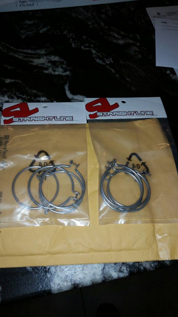

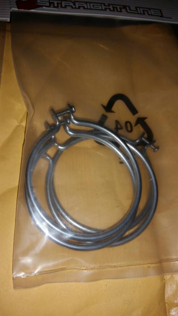

Just received rings in mail. NOT IMPRESSED!!! I am not one to ever complain but this is not going to work for me. [attachment=-1]uploadfromtaptalk1398764562837.jpg[/attachment][attachment=-1]uploadfromtaptalk1398764572741.jpg[/attachment]

I have said since day one that it is a thread issue. The threads on the bag and the ones on the fittings do not match. The plugs that come with the bag will tighten down as tight as you can get them but the quick connect ones will not. If you look close the threads are different. I'm positive we can get a better fix than this.

I fail to see why anyone would want to use SL bags in their boat after reading about these issues. I still haven't seen a real fix, just a bandaid.
AJ, no offense but the majority of people here could probably care less about a few extra pounds if the bag design is flawed. What's the extra capacity good for if you can't keep water in it? I hope the new A24 bow bag is issue free for you, have you confirmed with SL that they will have new fittings? I can't imagine they would continue to ship them out like that knowing they need a fix.
