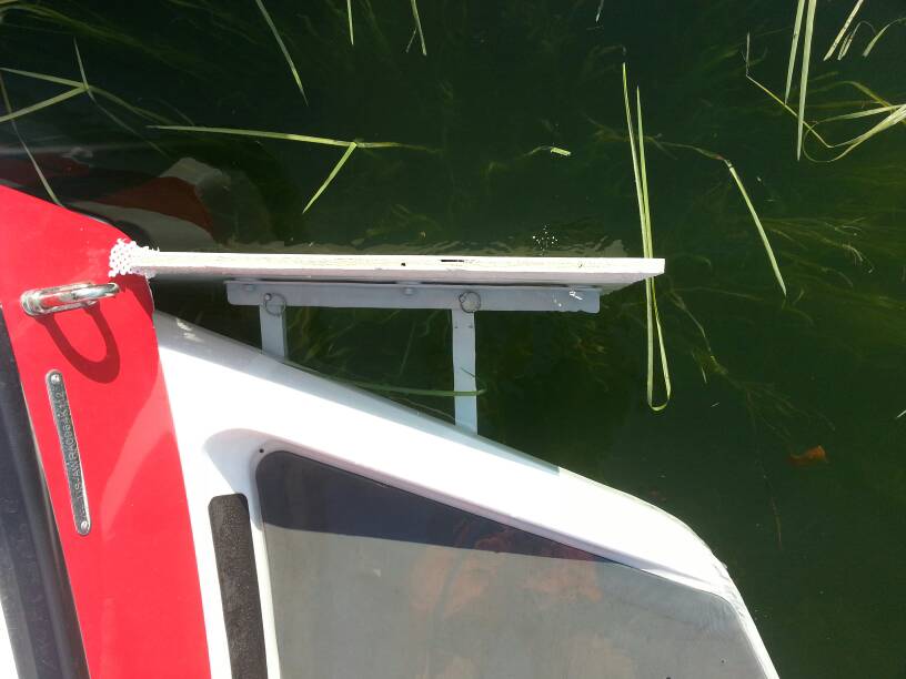

Just docked up after a little surfing.
I plan to make a new gate out of HDPE.

Yes steering is difficult at idle but the end results are totally worth it. I really like your mount idea especially if you could make it slide in and out so it could be deployed and not deployed and stay attached to the platform. I deff think you need to push it out more as you are not getting the full benifit of the gate

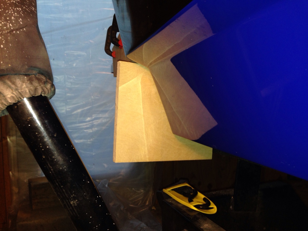

So I indulged on my NSS idea, and my initial concern was that NSS sits flush with the transom and it was going to be impossible to replicate that with the axis hull. So I made a very very crude attachment to see if the the idea would still work even tho it's wasn't flush with the hull.
 Post subject: Re: NSS !!
PostPosted: Sun Jul 20, 2014 11:00 am
............ It failed, but not for the reasons I thought it would. First off its to big, to much resistance, I would get to about 8mph and it would just rip it right off. Second the water spray was crazy bad. It's was spraying up and onto the sundeck. So I have to back up, research alittle, and modify the attachment.
So after more research I realized that NSS is completely under the water line unlike surf gate which extends up to the water line. So I'm going back to try and make the paddle smaller and more under the water line, under the platform.

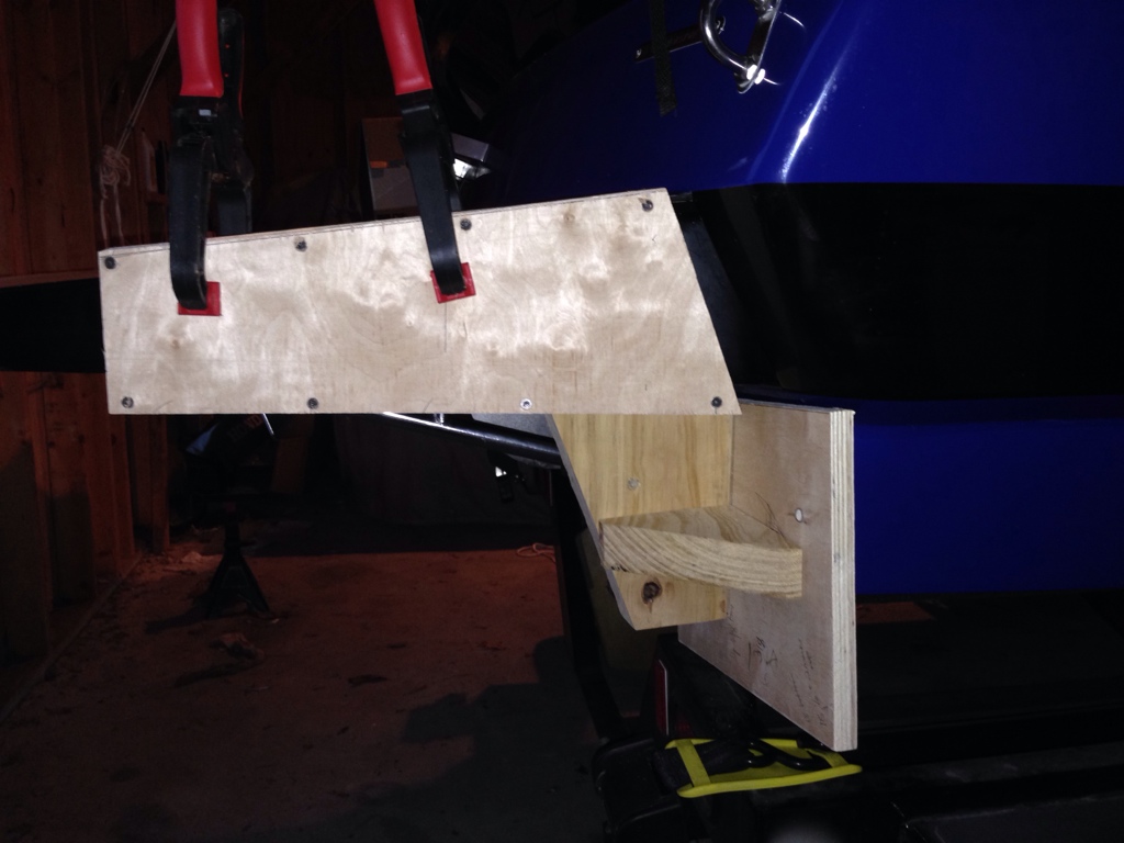

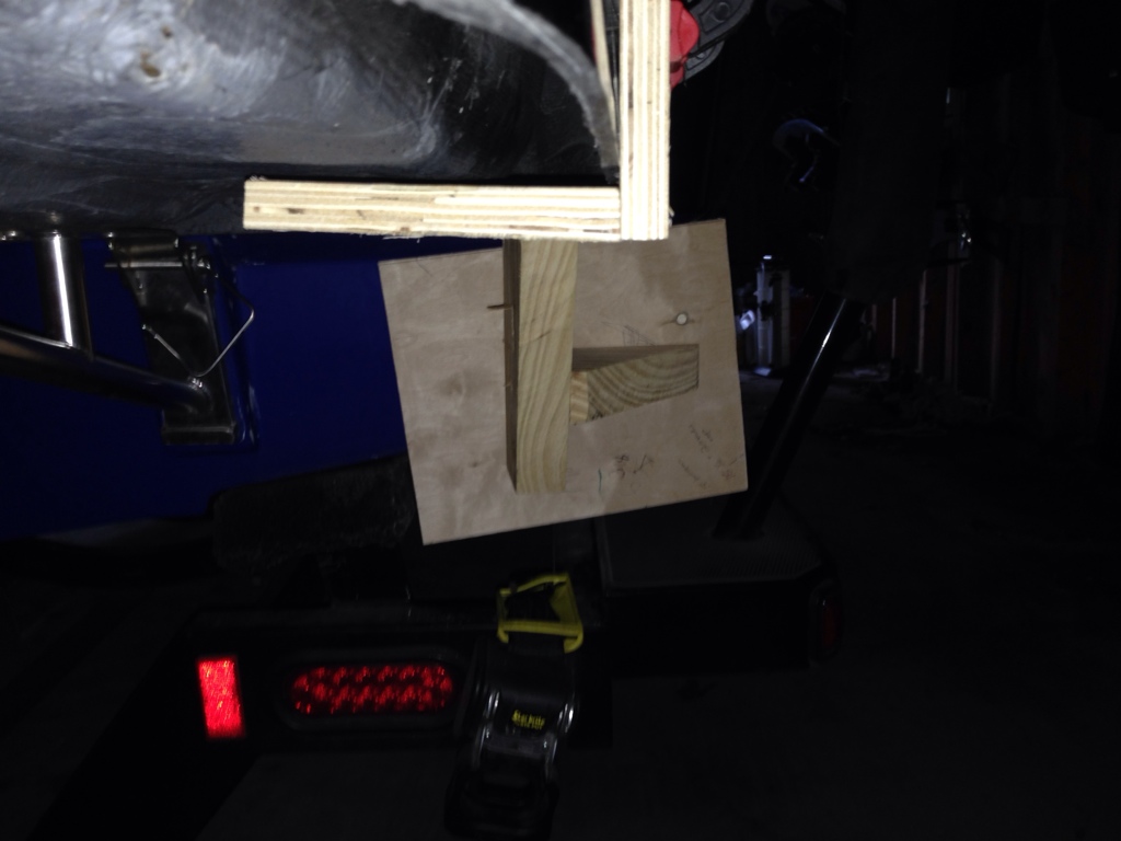

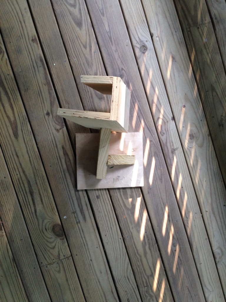

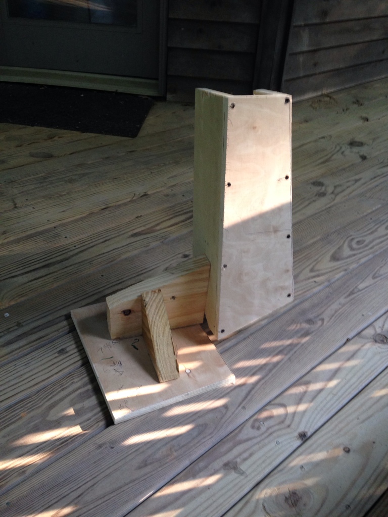

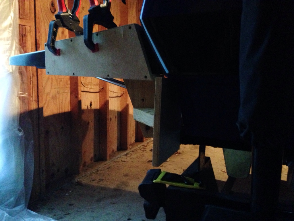

Ok so here is prototype #2 I like this however it's going to be difficult to mount if any body can think of a creative way to attach this the same way 1joey is attaching his wicked wave stuff the would be helpful but for now with this ruff prototype it's going to clamp on

Looks like too much surface area too me. I think the g23 only protrudes 1 inch at the max setting.
