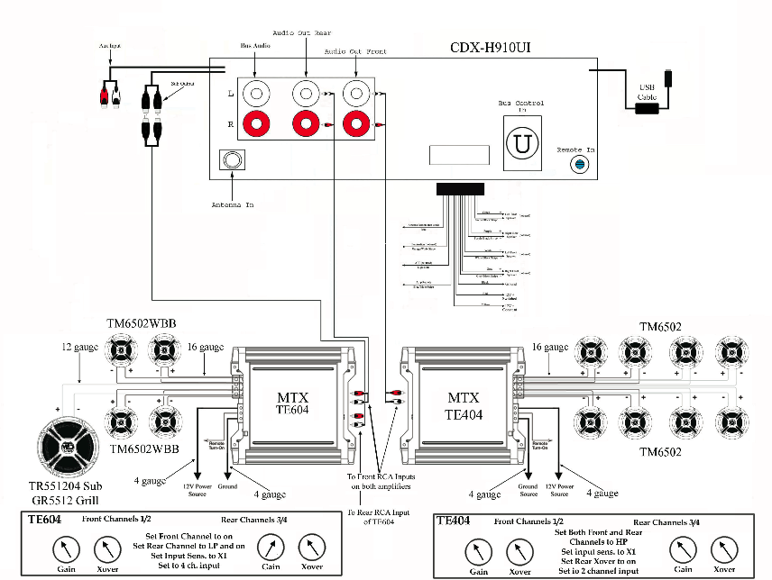

Running the MTX at 2Ohm is fine...other than a little more heat.

Hope this helps with the factory wiring.
| Attachments: |
