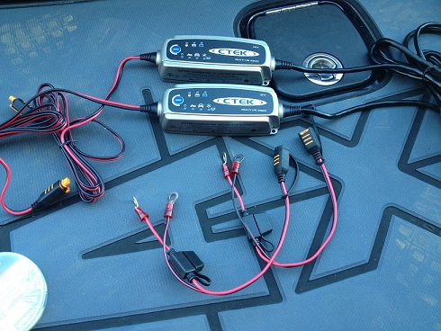

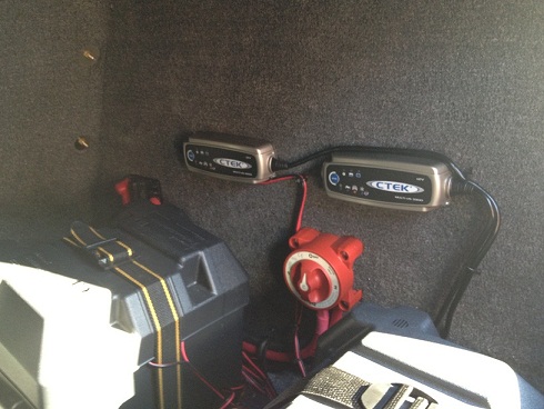

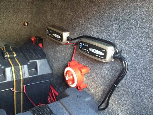

Here is a couple of pics of the install.

Clean install!
 Post subject: Re: Dual Batterys on 2011 A22
PostPosted: Mon Mar 26, 2012 6:18 pm
Turns out the CTek's have a specific mode for Optima and Odysses batteries so I hope in the long run it will help iut last longer. I will probably replace my Interstate with an Odysses next year and leave the Optima in place.
