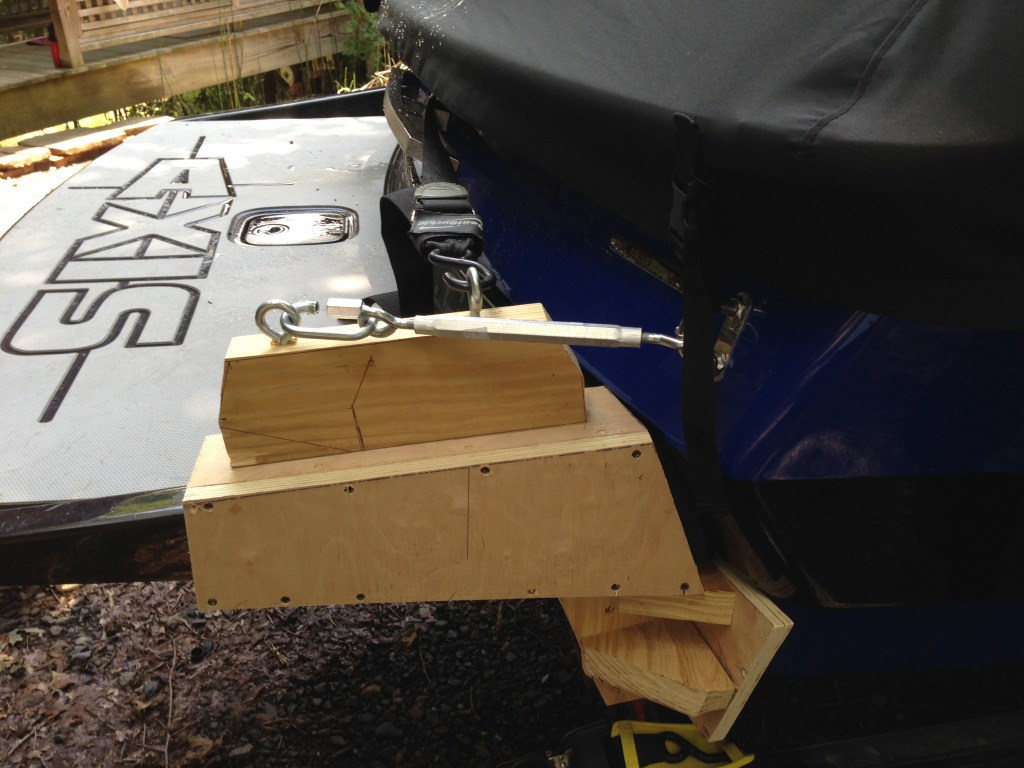

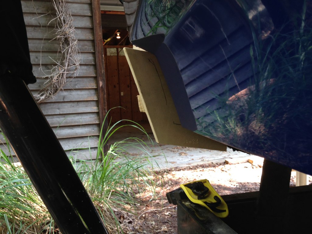

Well ....... Attachment failure..... Clamps no go..... So I have modified it again so I can use a turnbuckle and ratchet strap. However now that it is deff securely mounted I don't think it will work unless you have another ratchet under the platform. When I attach it and pull on it, it looks like its just going to twist the lower section off. Im willing to get in the water to attach the other ratchet but that option is not desirable if it's going to compete with the simplicity of wicked wave/ redneck gate. So I took you guys advice and trimmed it down, but not all the way down to NSS standards but now it only protrudes 2 inches from hull ...... I'm still doubt full that it will hold, I'm going to try it today with and without the under strap to see if it's worth moving forward or not.

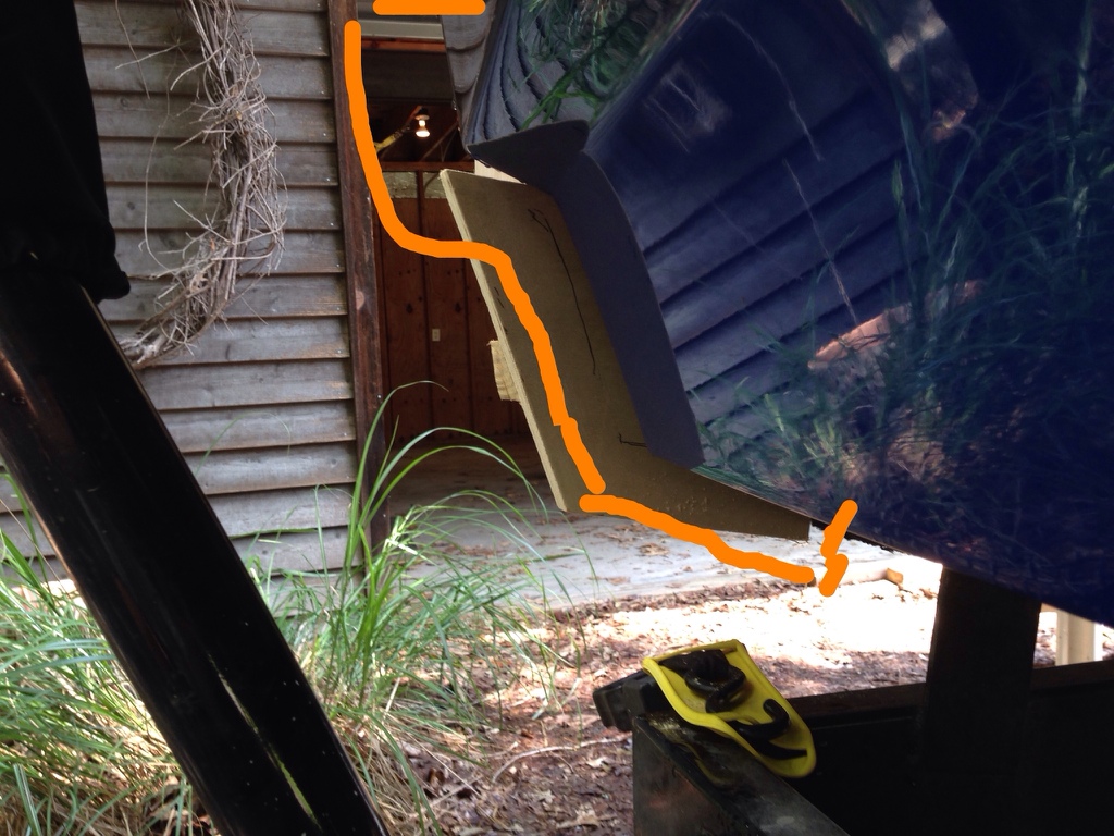

SO take this with a grain of drinking all day salt....only bother testing with the weight you expect to surf (dry tests is inconclusive). I think the nss needs to come up to the water line when you are fully loaded at idle (in my case its the black/blue seam above the swim deck). I wouldn't worry too much that the hull does not come to right angles against it. I think the engineering key is length of the surface area while minimizing the width. so try something like this:
If you think about a surfgate at a 15' angle, it has the same 2D shadow (void) in the water behind the boat.

So you think it was to far in the water so there was to much coming over the top? And I should make the paddle go higher
