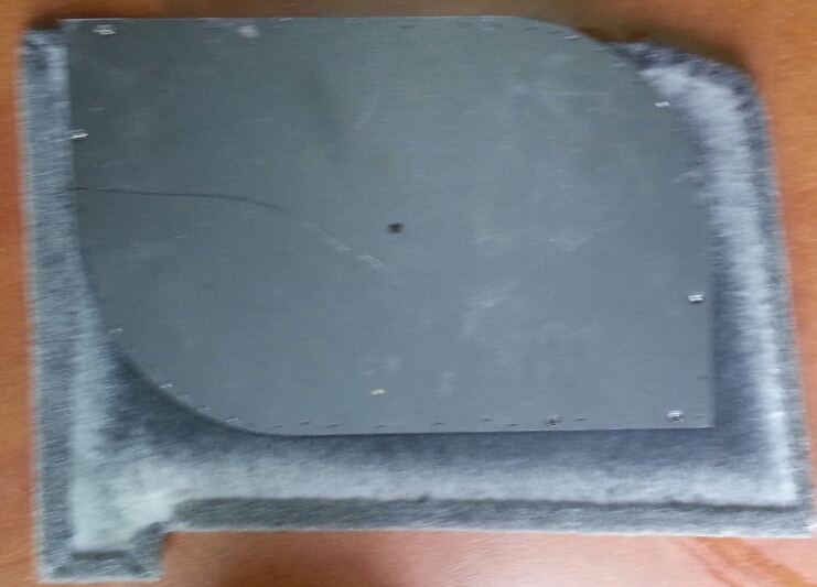

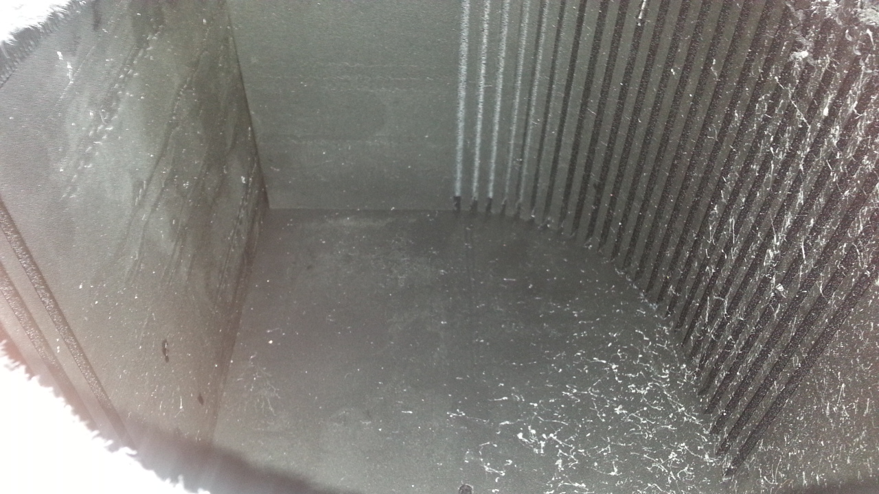

OK sound from stock sub enclosure, kinda disappointed the factory couldn't do better ... the measurements are 19 x 12.5 x 11 which is oversized. Nothing glued / sealed, holes for the wires left loose. The plastic enclosure is 3/4 poly, thin front, I think about 1/2" thick. Attached are images. About all that could be salvaged is the carpeted cover. I do like the idea of the plastic materials but they'd need to be thicker.

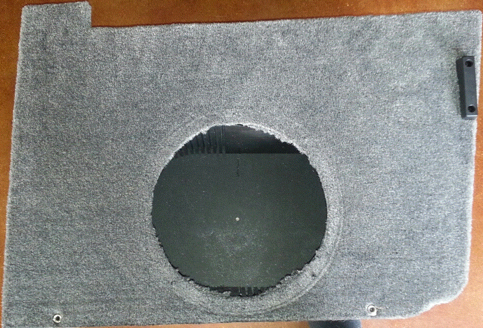

another front pic

Going to try to seal the enclosure from the inside ... while this isn't perfect, it would at least come close to the manufacturer's guidelines. The plastic is at least as dense I'd think ... with the exception of the grooves which allow the enclosure to bend ... for that, I'll fill with a fiberglass resin and hardener then seal the hole for the wire.

Sealed the enclosure best I could using silicone at the interior joints and fiberglass resin to fill the interior slots from the curved bends. Also added 8 screws to secure the front panel. The wire that was slipped through a small hole in the rear to the sub was attached to a speaker connecter I installed (bought from Home Depot) then sealed the adapter from the inside and added a new short wire from it to the sub. There's a noticable differrence. For the $30 spent on the adapter and fiberglass resin it was worth it to me. Next investment would be a new box and front panel, not a huge addition in cost but certainly time ... at least was able to use the original box.
