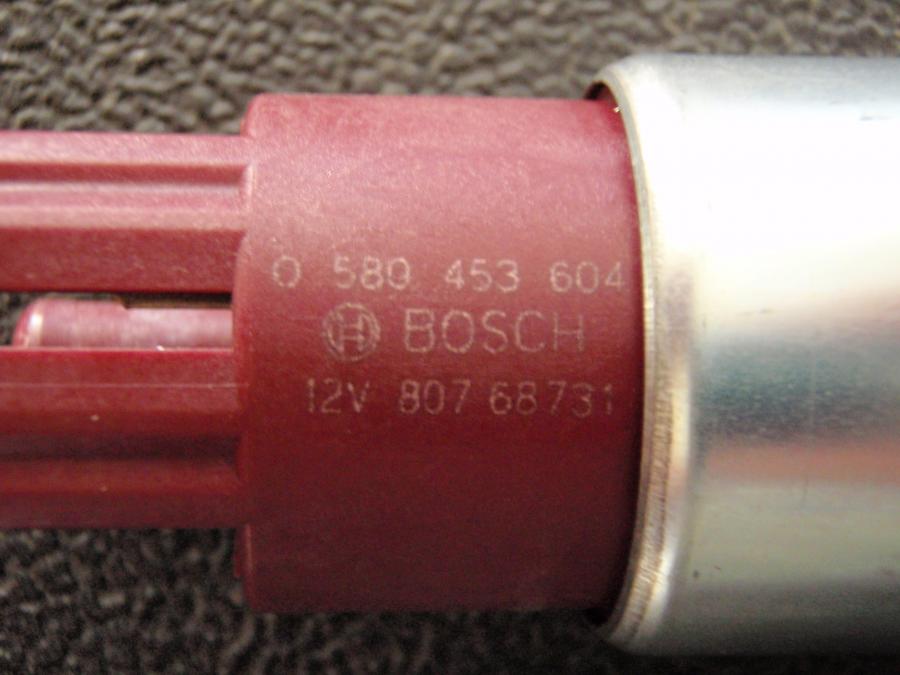

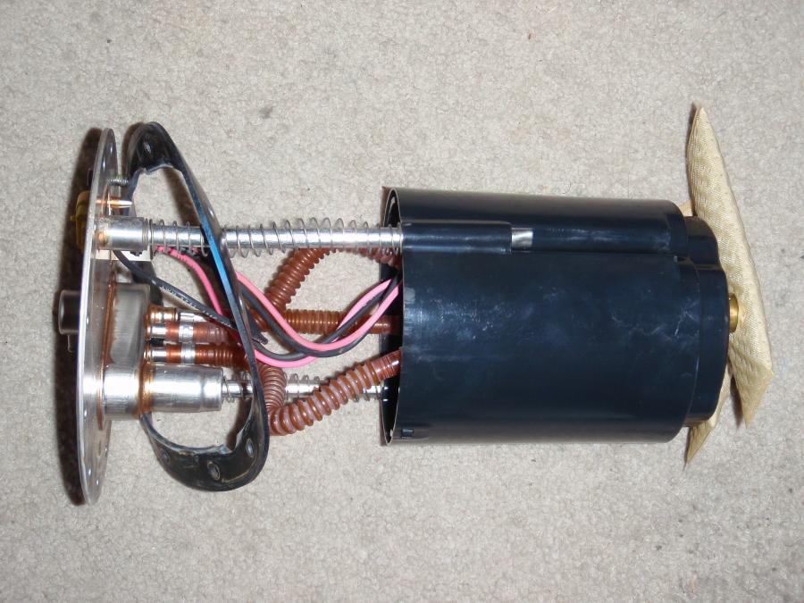

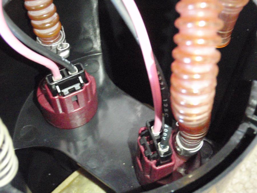

I had found a post on the mastercraft forum that showed the pumps from a 23LSV and they were Bosch. They took one to Napa to try to cross-reference and the number was found to be proprietary so they couldn't buy a replacement from them. I searched the number on Google and found some cross references for a few different pump numbers (E2471, YL5Z9H307FD, YC2Z9H307BA, KL1213350H). Here are the pics from the fuel pumps on the 23LSV.
 Post subject: Re: problem starting
PostPosted: Wed Jul 30, 2014 1:04 pm
That looks like the twin pump setup that's run in the ford GT, I've done a few conversions on mustangs and those have the ford connector.........and look very similar..........
PostPosted: Mon Aug 04, 2014 10:33 am
the E2471# is an air tech number which is the common brand carried by any/all aftermarket parts places the next two # (YL5Z9H307FD, YC2Z9H307BA) are ford part numbers, the last on im not so sure about it kinda looks like a dodge # but doesn't come up so it could be just a generic #
