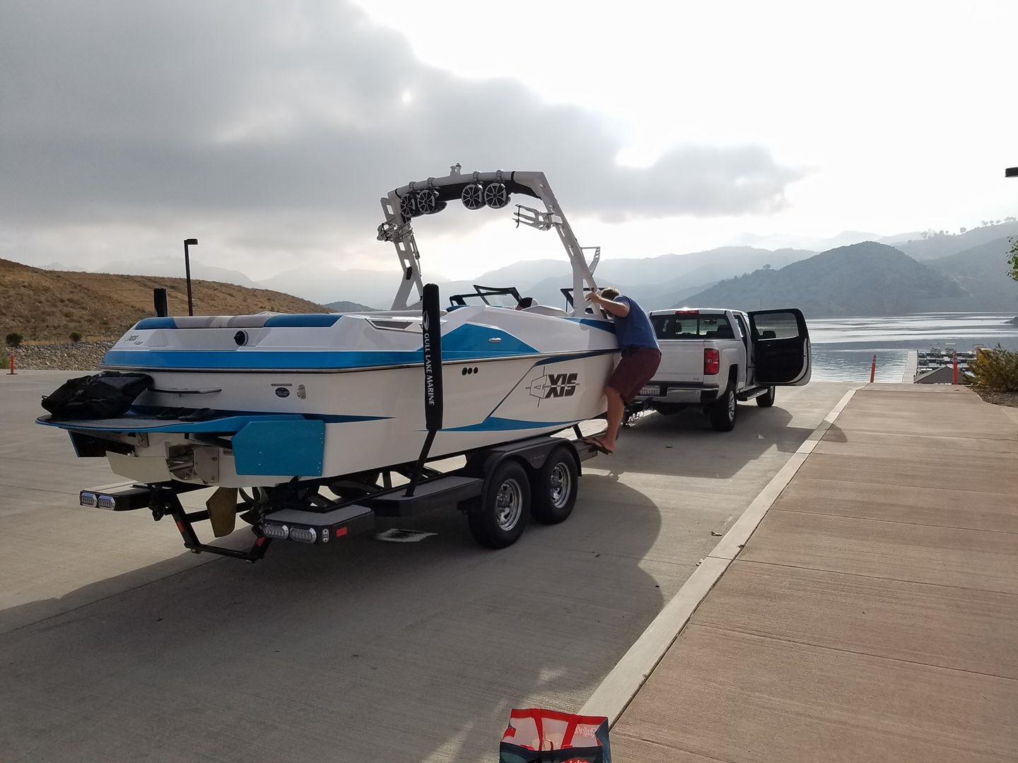

I just bought the PNP 1100's for rear trunks, 2313 prop and have 1000 pounds of led for the bow.
20369530_10155584390366810_7637572906030267693_o.jpg [ 272.02 KiB | Viewed 40339 times ]
2016 T23, 3600 rear, 400 sides, 1000 bow 2313 Prop
