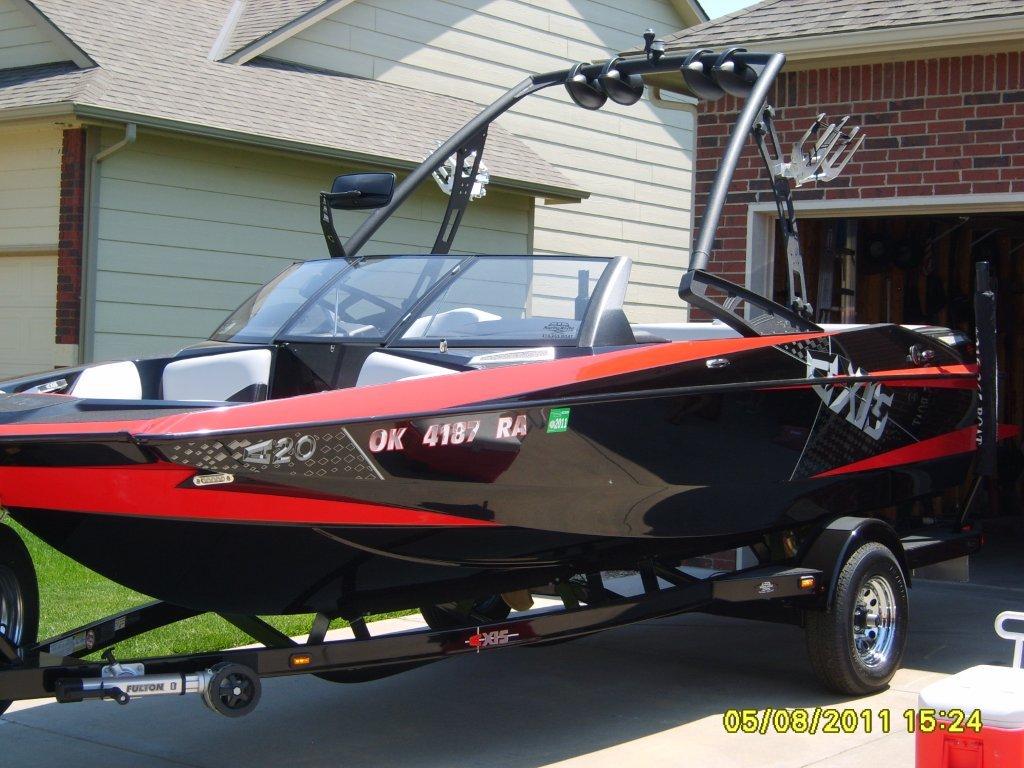

Heres a photo of the switches I'm talking about, and one of the boat for the hell of it, looks killer!
