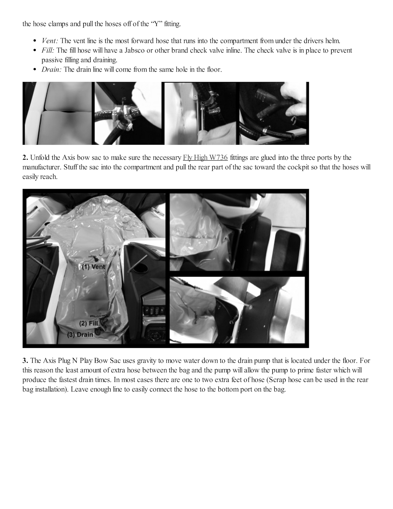

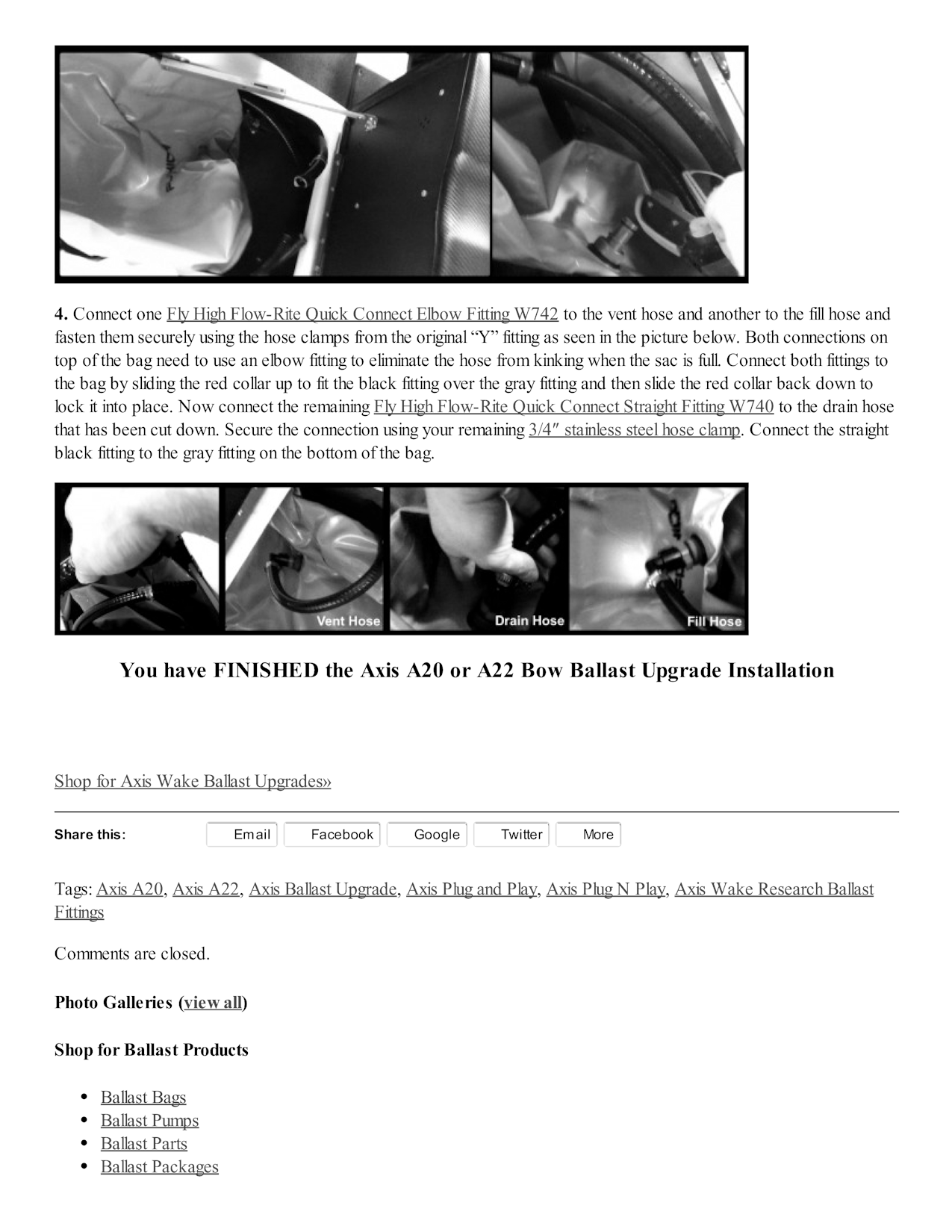

So I found an illustration that shows how to setup the front bag and the 2014's are still like this. Basically, disconnect the 3 hoses from the wye (Y) fitting and connect as illustrated, cut out extra hose and save it as you do not need it for the rear lockers on the 2014's and in regards to the 2014 rear lockers, the hoses need to be cut down to proper length as well for the best fit and placement (to long for the FLYHIGH 400lb bags). I found that the rear lockers need 2 straight connectors (W741) for the drain tubes, and a 90* elbow (W746) for the fill on the top of the bag. The front arrow bag needs two 90* elbows (W746) (Fill &vent) and a W741 straight connector for the drain. Rear bag install is very straight forward, there are 2 drain tubes (one at each end of the locker) and the fill tube is the one with the ball valve attached to it. Use the 2 W741 on the drains and connect, and use the W746 90* elbow for the fill tube and connect. Very easy.
NOTE: If you have an older model with 3/4" lines, use the fittings in the illustration. If you have a 2013/2014 with 1-1/8" hoses then use the fitting I have listed below for you. The kits from Wakemakers (which I ordered) did not have all the right fittings. It had to many W746 elbows and not enough W741 connectors and a crap load of W743 that I didn't need which is why I have listed exactly what you do need below!
Items Required for a 2014 PNP Front and Rear install (3 Bags Total):
4x W746 (90* Elbow Connector)
5x W741 (Straight Connector)
9x W743 (1" Screw-in connector for the bags) NOT NEEDED FOR FLYHIGH BAGS as the come with these already cemented in!!!
1 Tube of Marine Silicone
Install time: 30-45 mins
NOTE: If you want to Vent the rear bags you will need two extra W746 90* Elbows, 8 SS hose clamps, and two 1-1/8" Tee or Wye Nylon or PVC fittings and some extra 1-1/8" hose to tap into the rear hard tanks vent tube.
Really hope this helps anyone wondering how to do the install on a 2014 Axis PNP system.
Sincerely,
Mulisha911
