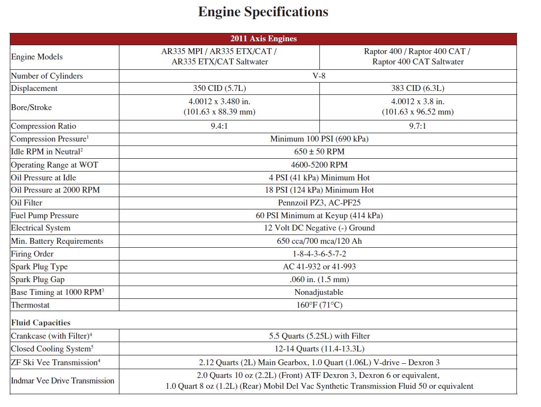

I have a Axis a22 2009, with the 335 Indmar engine. My question is what sparks plugs and oil filter its is possible to put on my boat ... Thanks you very much Alex
