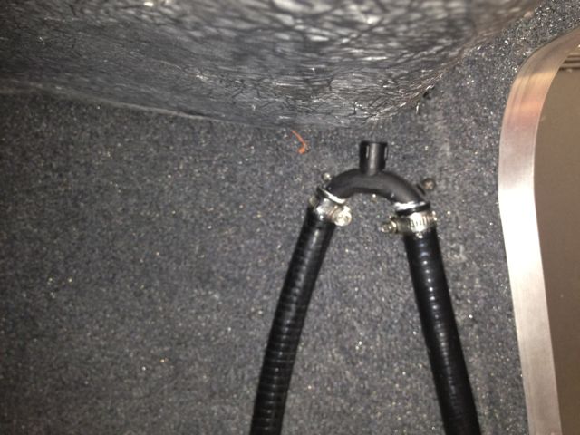

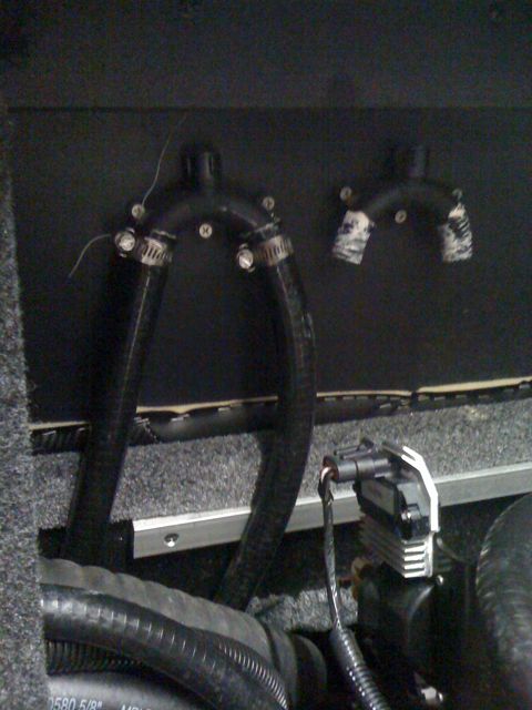

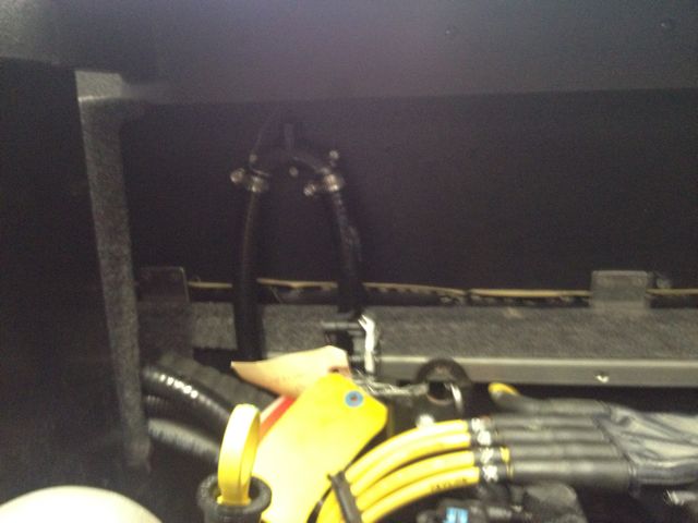

Start by removing the the cover under the skybox seat and the engine cover, remove all hoses from the vented loops and take off the 2 inner vented loops, (these just keep the water from syphoning out of the bags, you only need 1 per side) follow the hose from the pump and hook it to the inner leg of the loop, then run another hose from the outer leg to the top of the bag, then take the one going into the floor hooked to the tank and hook it to the front lower port on the bag. Do this on both sides and you're done in the rear section.
File comment: look on the seat back just in front of the engine, locate the 4 plastic hoops, 2 on each side with hose attached to each, remove all of the hoses from the hoops
File comment: on each side remove the hoop closest to the engine, you do not need 2 on each side, 1 for the left and 1 for the right is sufficient
File comment: follow the hoses from the pumps, (next to the transmission) up to the hoops and connect the pump hose to the inside hoop leg, the one closest to the engine, do this on each side

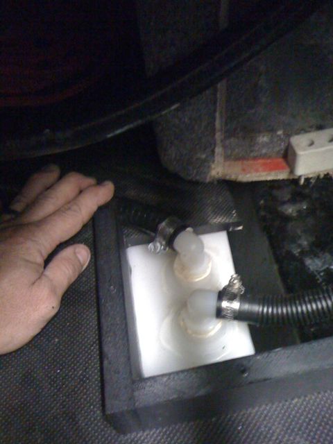

File comment: its not necessary but if you want the bags to drain and not take forever remove the cover for the tank fill and vent and turn the forward fitting so it faces forward, I went counterclockwise just to make sure
I didn't over tighten it.

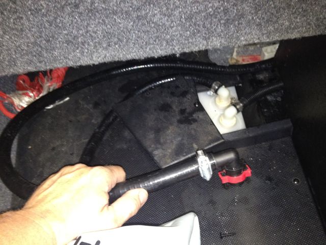

When you are finished with the rear section you should follow your hoses to make sure they are right, start at the pump in the floor, then it should go to a hoop on the seat back, from the hoop to the top of the bag, from the front lower port on the bag to the tank, done, I have tried many ways on hooking up the bags and this is the most foolproof and hassle free way to do it without spending a ridiculous amount of money trying to save yourself 5 minutes.
File comment: try to keep this hose between 18-24 inches and I recommend not using a quick connect fitting, it drains faster without all the 90 deg fittings, if you have to use one get a straight fitting

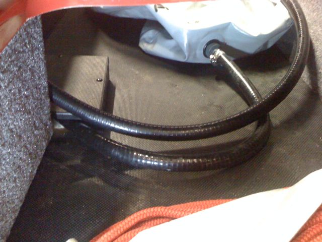

File comment: loop it around to the front of the bag and hook it up

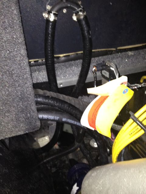

File comment: now take the leftover longest hose you have and put a 90 deg quick connect fitting on it and hook it to the top of the bag, run the other end over by the tank lines and run it up to the loop on the seat back

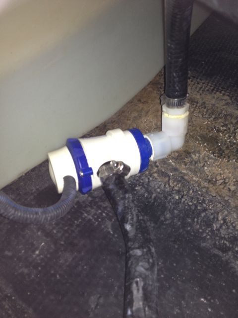

File comment: this is the front bag fill pump and just above it is the tank vent line
File comment: these are the tank drain and fill pumps
