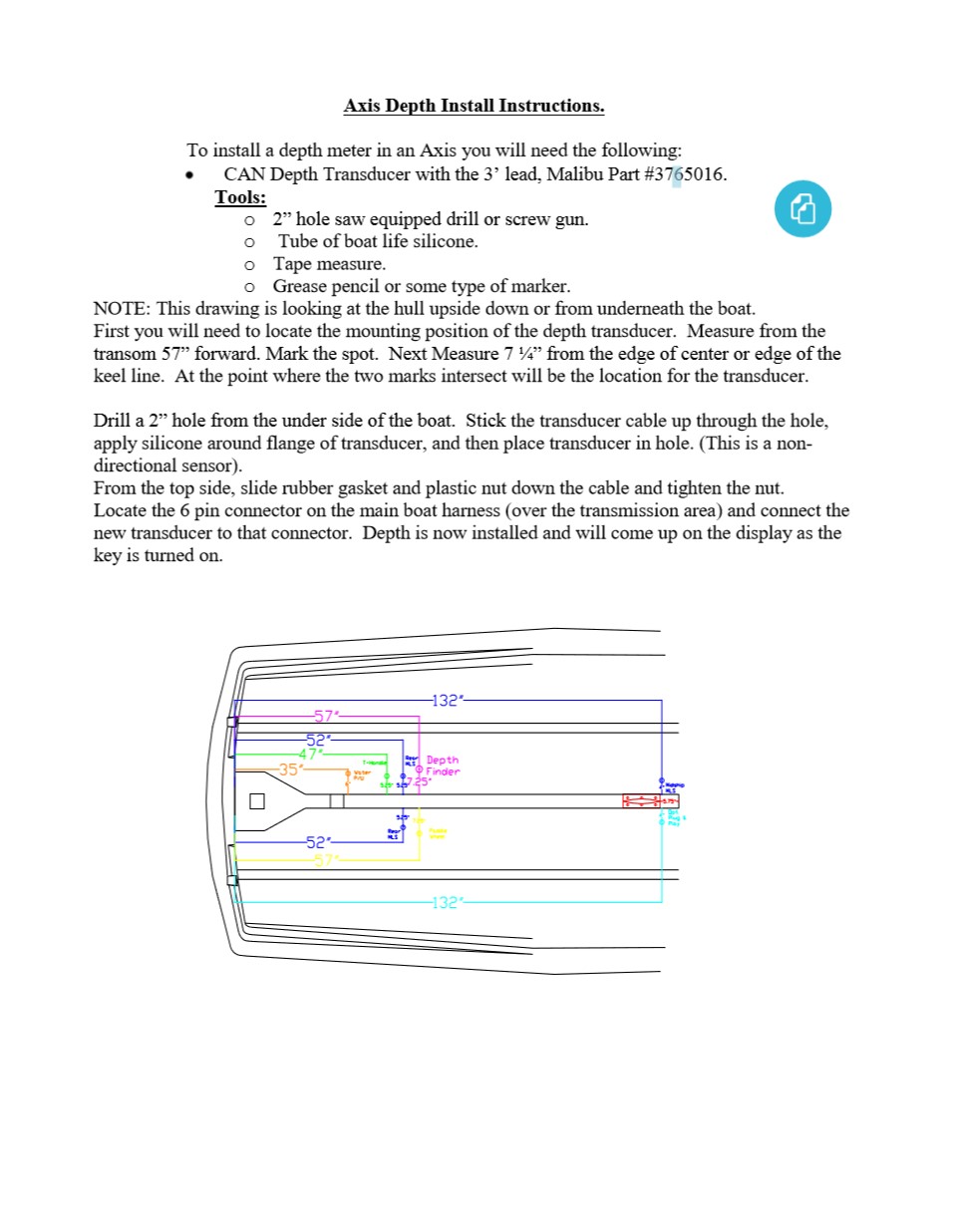

Note to A24 owners (possibly others) the transducer is designed to go next to the front ballast pumps not in the rear by the transmission (per Axis tech support). The plug is right under the large plastic access panel under the carpet. I had to run the wires over the gas tank as I installed the transducer before finding plug (Im a dumb ass but it will still work fine)

Got install instructions from Axis in case anyone finds them useful
