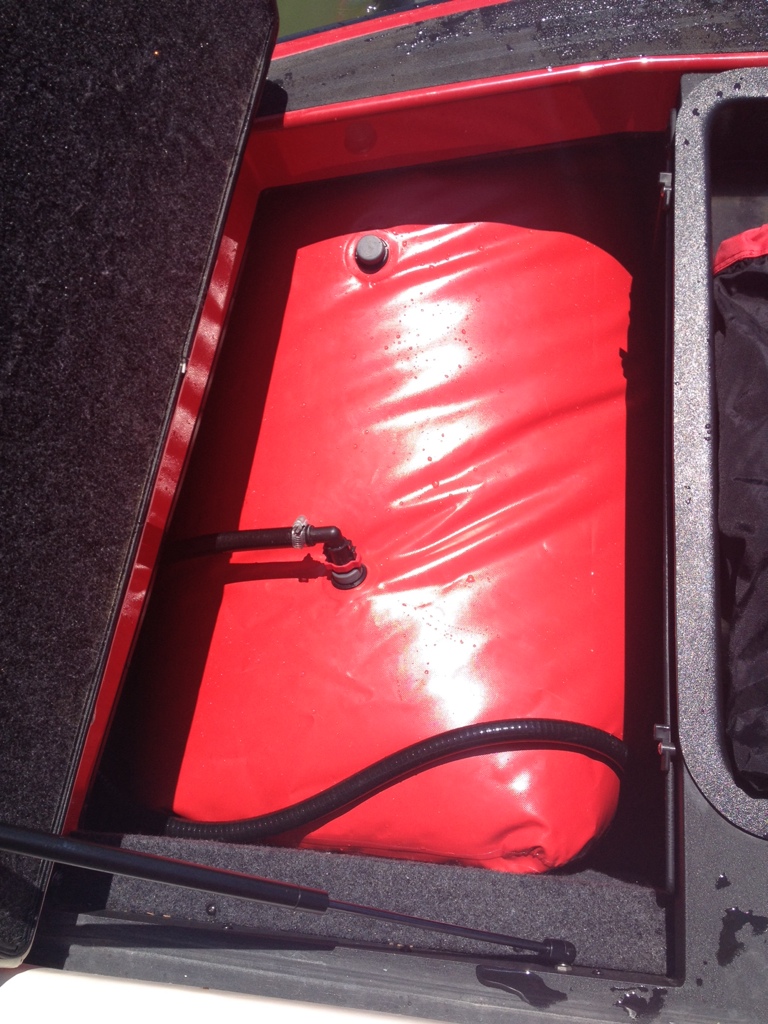

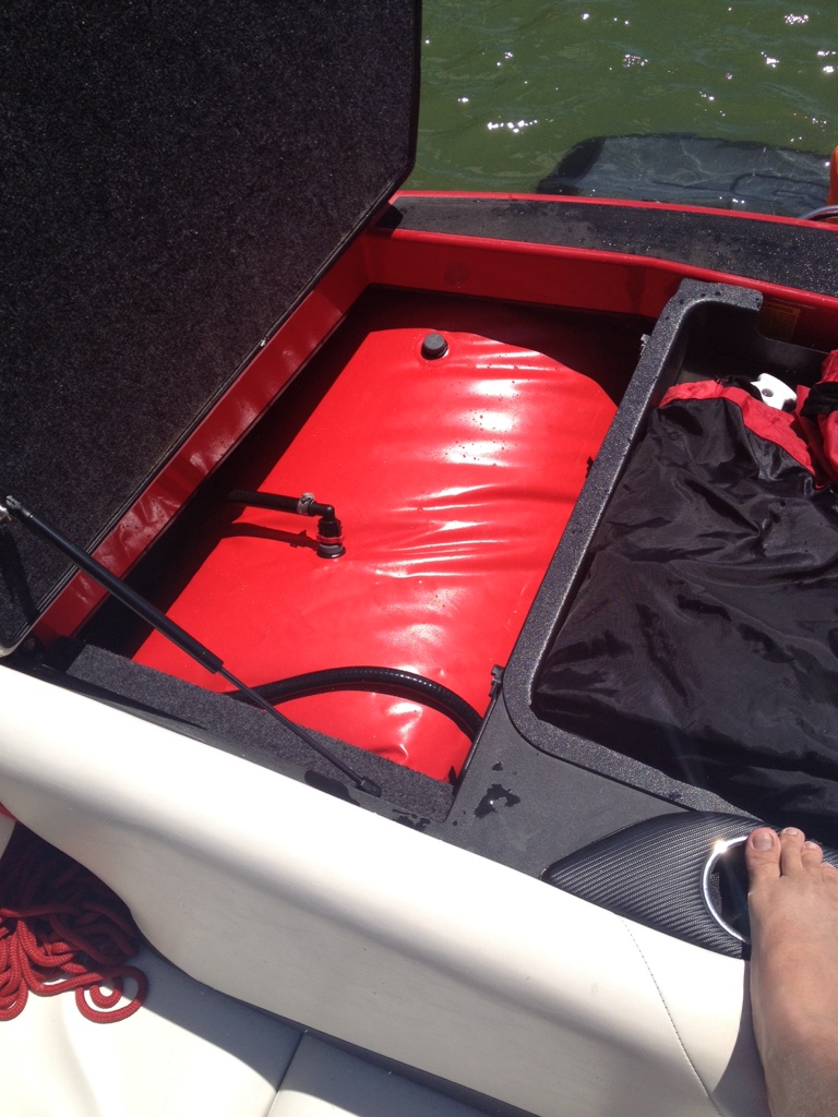

They fit great, they do put a little pressure on the engine divider, it pushed in about 1/2" to 3/4" but did not pop off track, they filled completely and went all the way front to back without bunching up, now I need a little more prop, at 1050' elevation with full stock tanks, front pnp bag under seat and these two rear bags, full tank of gas and 7 people on board totaling about 1000lb the only way it would plane is if 5 people were in the bow, I guess now I need a 2315... No wedge used yet, it did set the swim platform about 8" underwater :o
