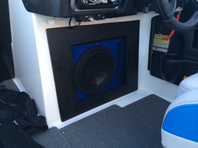

finally finished mine... looks great and doesn't vibrate!
1/2"mdf
sealed with resin
sprayed bedliner
secured with velcro
Thanks for all of the tips.

lol... in this pic you can see the speaker more than you can in person.
this set up sounds great. I paired the type r with an alpine 1100 w amp
