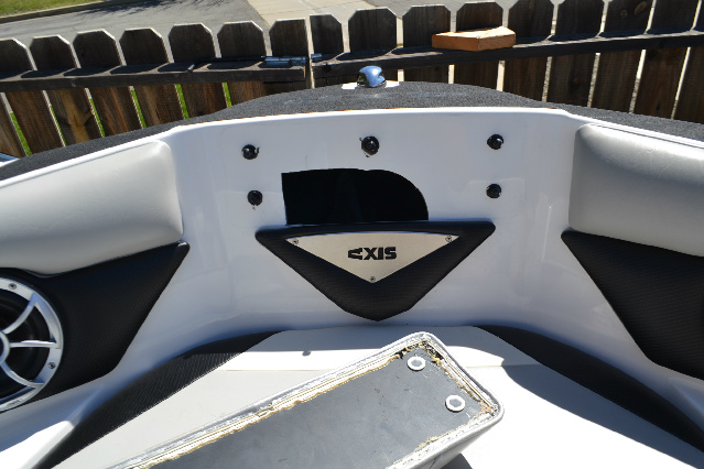

otown
here is that picture. You can see half of the original circular hole for bow access. I cut the left side out in order to slide a lead-wake bag in there (8 of them). I have a pop products bag left over and it would not fit unless i cut more. when the cushion is snapped back on, you can not tell at all. Also, use plastic to pry up one corner of that cushion, then it will pop off real easy and snap on as well. then 3 screws and the bottom triangle piece comes off.

Awesome thanks! I will definitely try to get this done...
