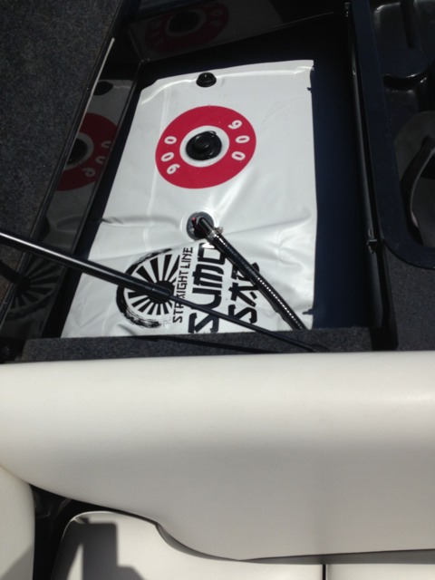

Has anyone tried the Sumo V900 sacs to see how they fit in the Axis lockers? If so, any pics?

Did you reinforce the side walls for the 900? Happy how the 900 fits? Lockers the same size on the A20 vs A22?

I'll be reinforcing the walls. I've used the 900s for a week and the force was sufficient to push the divider out of its track on one side.

Anyone have a picture of how the 600 fits into the locker. I was all set to order the 900's but not interested in reinforcing the side walls if the 600 will work fine.
