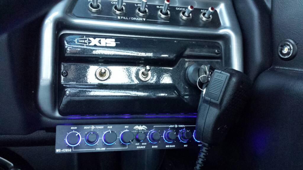

Can someone show me how they installed their Wetsounds 420 under their head unit? I pulled mine from my last boat and I want to install it on my new boat. I ghetto rigged up on my last boat. I am trying to decide if I can do it myself or just pay a shop. I know how to wire it up properly. My main issue is the mounting. Let me see some pics of how you guys mounted yours.

I didnt put mine under the head unit. If you decide to put yours under the toggles, i can talk you through it.

Here is what it looks like 2013 model a22

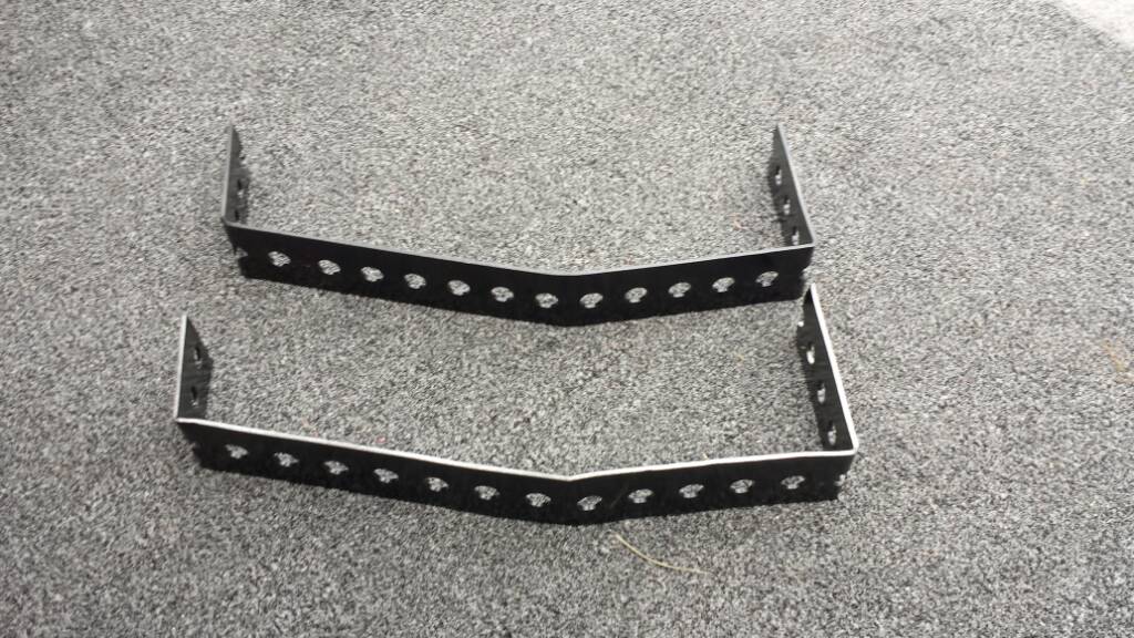

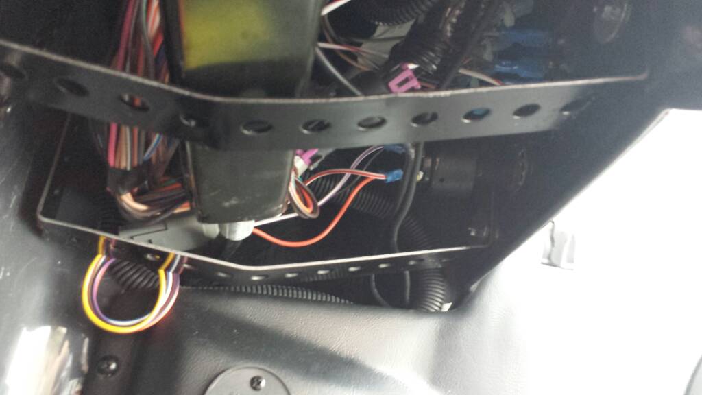

I made my brackets from some hangers that you can buy at lowes. You need some tin snips to cut them, fender washers and replace the two lower machine screws in the dash with longer ones.
