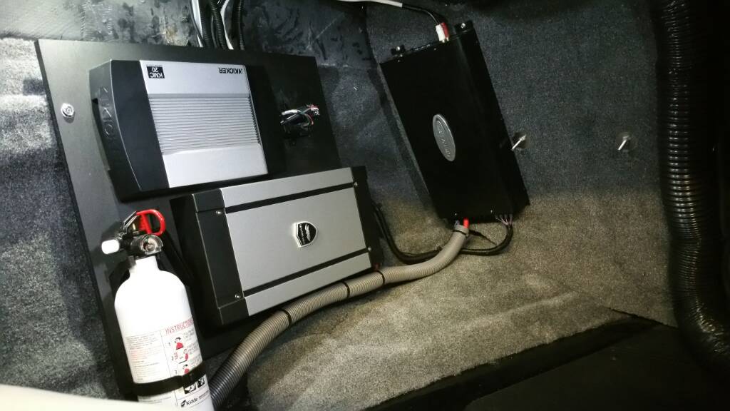

Skibum wrote:
Oh, for some reason I thought I read that SP1 still utilizes an amp.
SP1 will come with a smaller amp board and the little kicker media brain will be mounted to it, the kicker brain is 50 watts times 4 and is 2 ohm stable, it also has all the rca outputs coming off of it. I ordered my boat with SP1 and added the HT6 for the 6 in boat speakers and sub and the Arc Audio 600.2 for the pair of Rev10s.

I like that mounting position for the fire extinguisher... I will be copying. :-)
