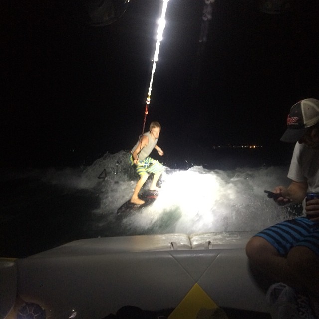

I just installed these Tuff Stuff Performance 10" Led- 12" Off Road Led Light Bar Flood/Spot Combo Beam- 3W Led-72W-4500 Lumen. . Got them off amazon fit perfectly and are really bright. They are the only light source in the second picture.

Surfing is Illegal at night here in VT also but luckily Lake Champlain is huge so don't really have to worry about getting in trouble for it. I have the sound pack II on my boat and the lights came with mounts that worked perfectly on the tower. I will get some close up pictures of the mount on sunday. I still haven't had a chance to surf behind it at night yet as the nights haven't really warmed up enough to warrant a night session.

How did you mount? Did you just drill into the tower?
Also, my underwater lights are on the same switch as interior lights? How did you go about changing that?
 Post subject: Re: tower lights
PostPosted: Thu Jul 10, 2014 11:26 am
Posts: 48
I installed mine by putting hose clamps around it and put some hot water heater tubing around it so it did not scratch the tower. I have a quick disconnect on the light using a 2 pin trailer harness so I can take it down or swap out if necessary. We put a switch after the on position of the underwaters and a relay from it to trigger the light. I can have underwaters on only or kick on tower light. I cannot run the tower light without underwater though. Here are some pics I means to post a while back. Sorry!
