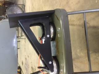

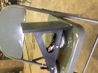

Here is mine. Will see how it does tomorrow.

Will do. I'll take one of it vs. the "poor gate" I'm currently running. I made it to try on my friends Moomba & another friends 2011 LSV. I might just like it better on my A22. We shall see.
