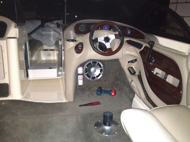

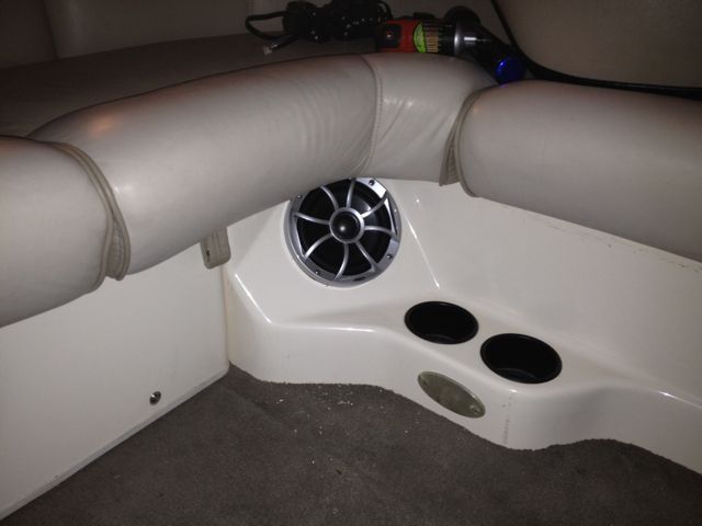

XS-650's are in. The Wetsounds sound better than the polk db651's. Not so much in the high/treble, but sound better in the mid-range frequency. I got a sweet deal on these. The construction is top notch and you can tell they were meant for marine use with all of the protection around cone/backplate. The polks are are great speaker for the money, and easily sound better than the stock MTX.

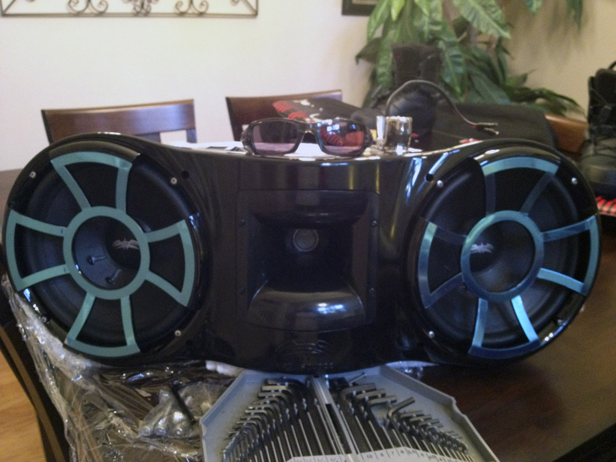

Rev10's finally have some company. :D

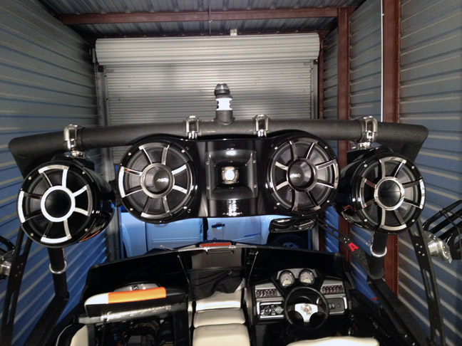

Here's the finished results... It's a big difference in how loud 2 vs 4 are. Install was pretty easy. Getting the 3rd cable up through the tower and drilling 3 new holes were the most time consuming parts.
I'll try and do some video on Saturday. Can't wait to ride Sunday!
