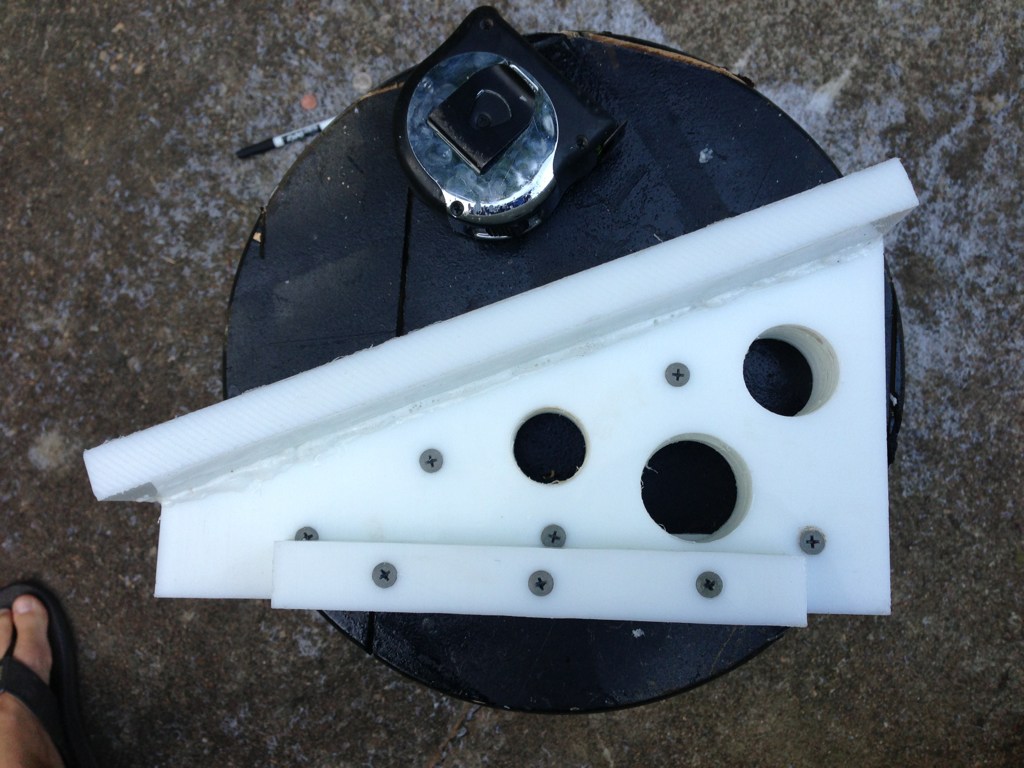

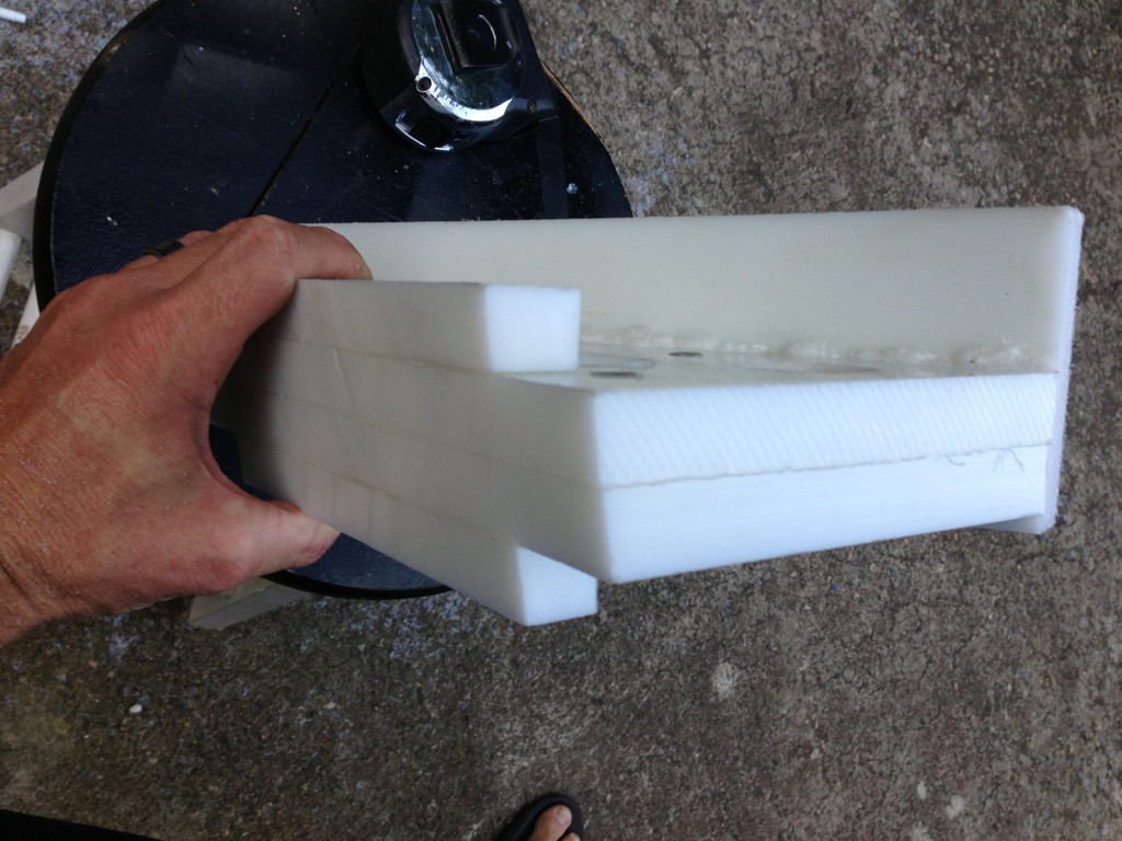

I finished my HDPE gate today. Hopefully it's the final one for me. That material is easy to work w and very strong. I made the mount a bit smaller to lessen the push of waves knocking it off at idle speeds. I also put holes in the triangle mount to allow water to flow thru when idling back to a fallen rider. I noticed at slow speeds waves of other boats would loosen the gate up some.
I reinforced some areas that I thought got more stress and decreased the pitch angle to around 8 degrees...
