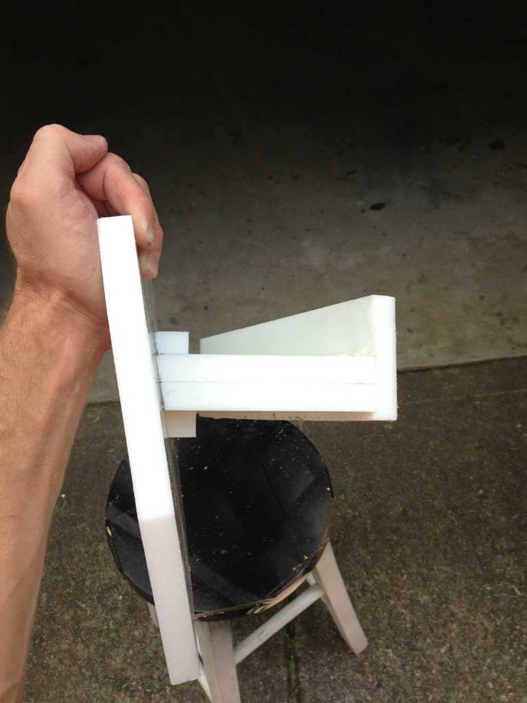

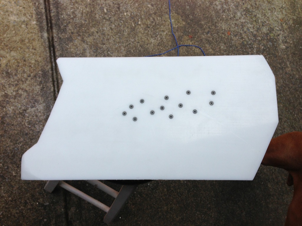

Fit it flush as well...
 Post subject: Re: Home made "Poor-gate"
PostPosted: Tue Aug 27, 2013 1:59 pm
Posts: 276

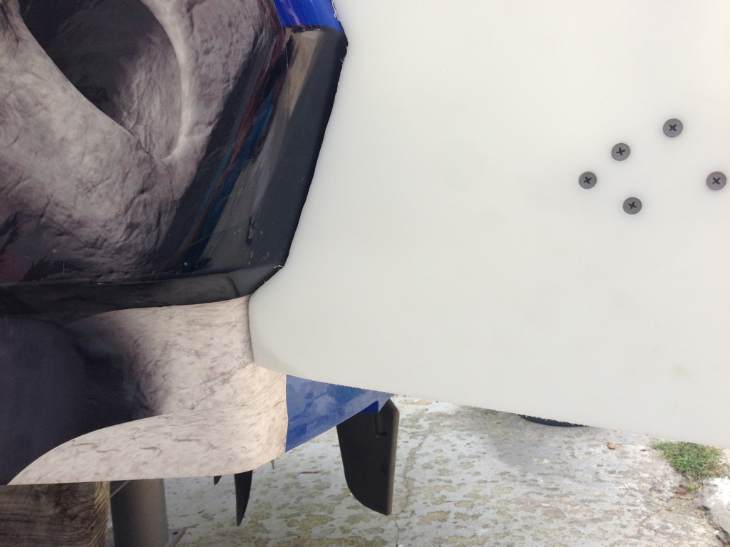

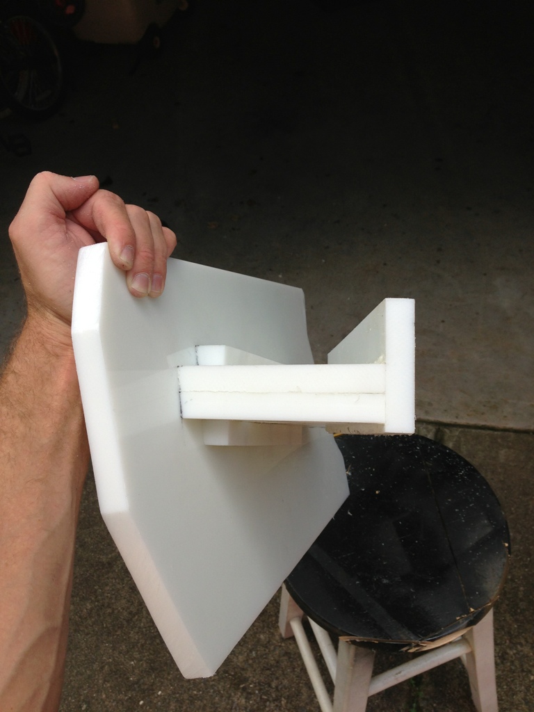

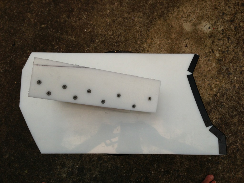

Finished product...

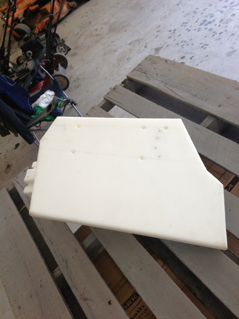

Hard part will be getting the angle the paddle is mounted at. I angle that a lil to replicate the angle of the true surfgate when its deployed. I just cut the paddle to fit the hull then clamped the mount into position and drilled into place. I piloted each screw tho.
PostPosted: Tue Aug 27, 2013 6:01 pm
Posts: 276
And the paddle size was the 12"x24", 3/4" thick high density polyethylene I ordered from amazon w the notch cut for the hull and the top and bottom corners cut to mimic the stock surfgate.

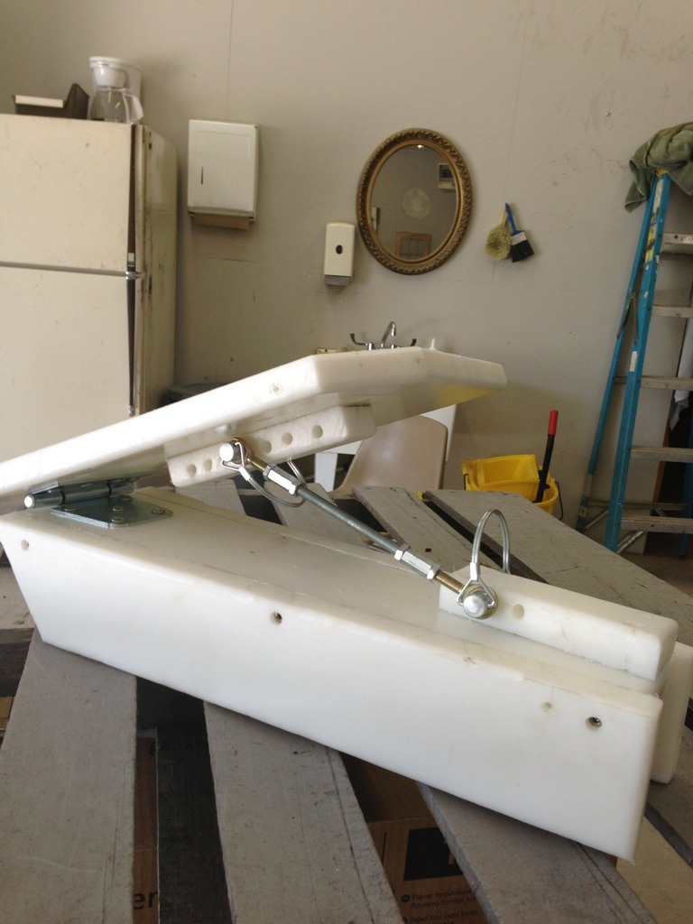

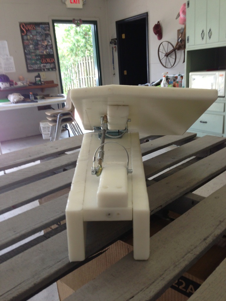

So I wanted my gate to be adjustable to different degrees and to close up for Easier storage
