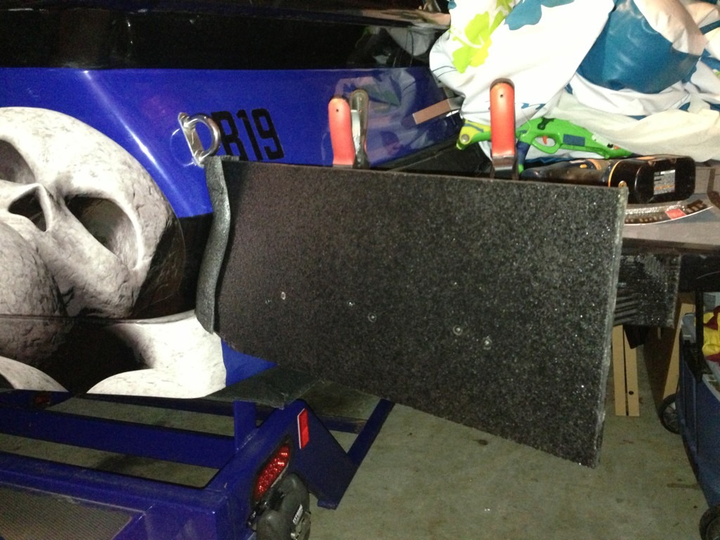

It is just simple 12 x 24 rectangle. Works great but will make some improvements on the next on when I have more time.
 Post subject: Re: Home made "Poor-gate"
PostPosted: Mon Aug 12, 2013 1:06 pm
Here are some pics.

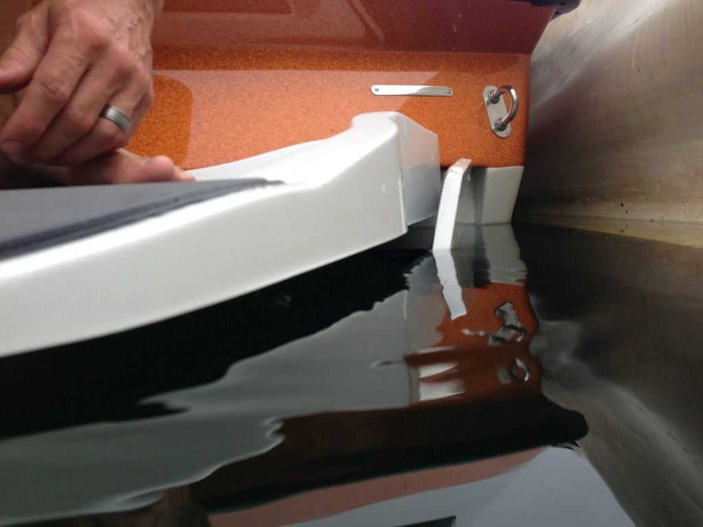

Thanks goducks. I was going to make mine flush with the deck at first but then I noticed that the new deck on the 2014 models has actually been raised up from the previous attachment spot. As AJ pointed out in a different thread the new deck no longer flows with the lines of the axis hull. So my DIY gate actually only sits a lil bit above where the stock gate would sit. Maybe an inch or so higher. Unweighted and at idle my gate sits 3-4" out of the water but weighted with 750s in the rear it only sits maybe an inch above the water. I'm not getting a whole lot of spray above the gate when riding. Definitely not enough to spray up onto the rear of the boat. I'm not sure if less sticking above the water would affect the wave any. It might reduce some spray. Here's the 2014 stock gate compared to mine.
Relative to the tie down loop I'm about two inches higher than the stock gate.
