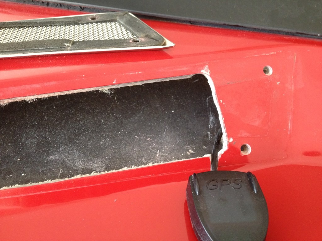

My GPS conversion came in, it took longer to find a screwdriver and file than it did to install it, very simple to hook up. I'll test it next weekend over the holiday. It had some pretty good reviews on bucrew so I decided I'd try it out, mine tends to surge about halfway through a hard turn, hopefully this will solve it.

I'll report back after memorial weekend on how it works, but I'm sure it will be good, and was all of 10 minutes to install
