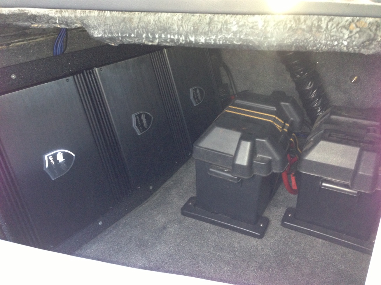

Finally got around to snapping some photos of my completed Stereo Install! I could not be happier. It sounds absolutely insane!!
Inboats - 6.5" JL Audio M650 Coaxials
Tower - Wetsounds Rev 410 and 2 Rev 10
Subwoofer - RE Audio SX12
Amps - Wetsounds SD2, SD4, SD6
Head Unit - Stock Sony
EQ - Wetsounds WS420
XM Radio - Audiovox CNP2000uca Tuner/Antenna
Knukonceptz Wiring/RCAs/Distribution Blocks
Custom Ported Enclosure 1.4 Cubic FT (Net) @ 36 Hz coated in Linex
Custom Trim Panel to Protect Subwoofer coated in Linex
Customer Amp Rack coated in Linex
Also installed a relay for the remote turn on to eliminate the pop noise when shutting off the system.
Enjoy!

Since 3 is the maximum.

That's a super clean install. I have the same tower setup, ws xs650 for boats and arc amps. That tower has to be louder than hell. I would have been nervous to tune it because with amount of watts you're pushing (1250x1 and 685x2) anything set wrong probably would have blown the speaker.
Why didn't you go with the XXX 12" sub? Just curious due to everything else besides cabins being WS.
 Post subject: Re: Custom Wetsounds Stereo Install
PostPosted: Wed Jul 31, 2013 8:48 am
Joined: Sun Apr 28, 2013 6:31 pm
Posts: 28
I chose my current sub becuase it was laying around in my garage from an old car stereo install. This sub is no slouch, it absolutely pounds and sounds incredible. Check out REAUDIO.com.
As far as the tower goes, it does scream, but I have the SD6 bridged to each tower. So each Rev10 is getting 685 watts and the Rev410 is getting 685 watts. Gain on the amp is only up about 1/4 of the way and it is very loud and clear!
