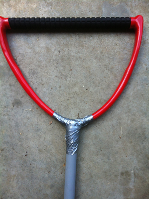

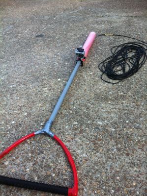

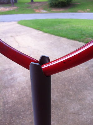

OK Gang. Here is my set-up with the GoPro. Really easy to do.
Section of PVC conduit cut down to 4'. May actually cut this down further once we get some shots and get camera at a proper distance. Right now we are at about 3' from handle V.
Used my Dremel with the sander attachment to make the V section for the handle to fit into.
Duck tape to attach handle.
Swim noodle on end for flotation.
GoPro handlebar mount to attach to PVC.
Will post pics after this weekend.
Still trying to decide to do video or a picture every second.
Anyone that has done this..... what settings did you use on video mode...? (r1, r2, r3, r4 or r5...?) Using a GoPro Hero.
