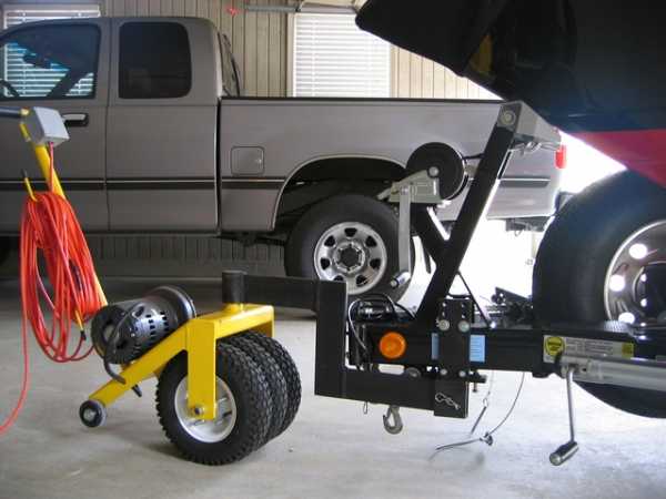

Alternatively an electric tug is fun. That is what I have, and my kids and their husbands can safely put the boat away with no chance of damage. Best thing ever if you are on pavement. This is a picture of one like mine. I bought mine used for $500.
