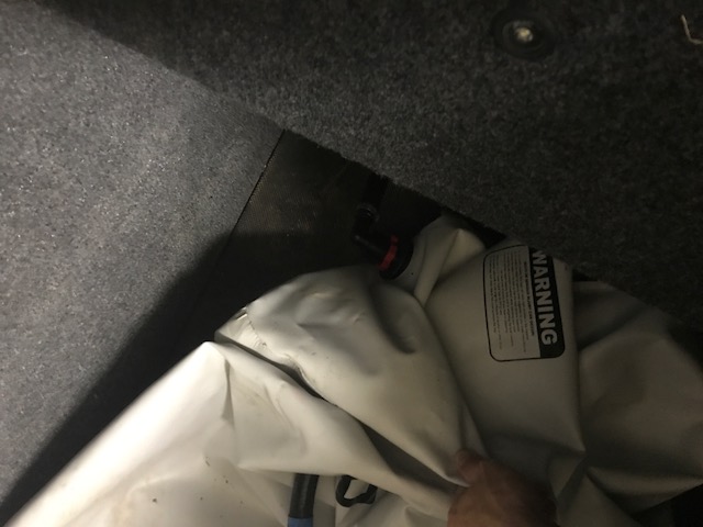

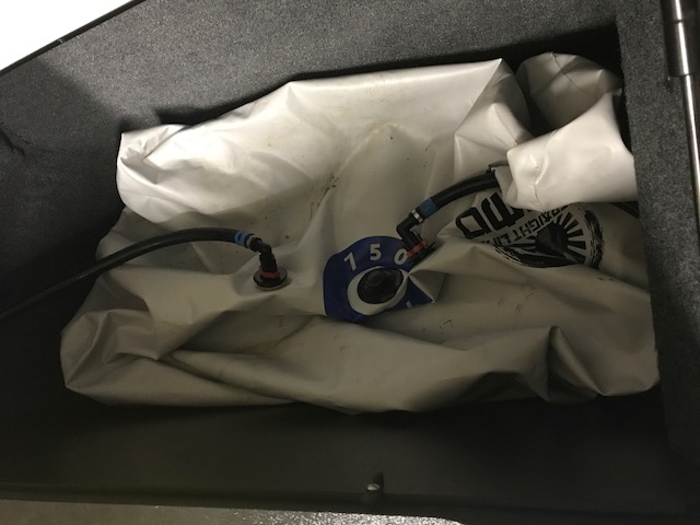

steveA20,
Here are some pics. I'm assuming that the one in the first pic that is under the bag and toward the front of the boat is a drain hose.The second pic with the hoses with blue are labeled the Fill and Vent hoses.

You'll want to trace the fill hose back to the pump. There should be a vent loop (upside down U shaped pipe) and there may also be a Y valve if they've split your fill lines for the bag and hard tank. If not, you'd have to connect the fill hose that you see to the drain hose.
Have you looked through this thread - viewtopic.php?f=14&t=137?
