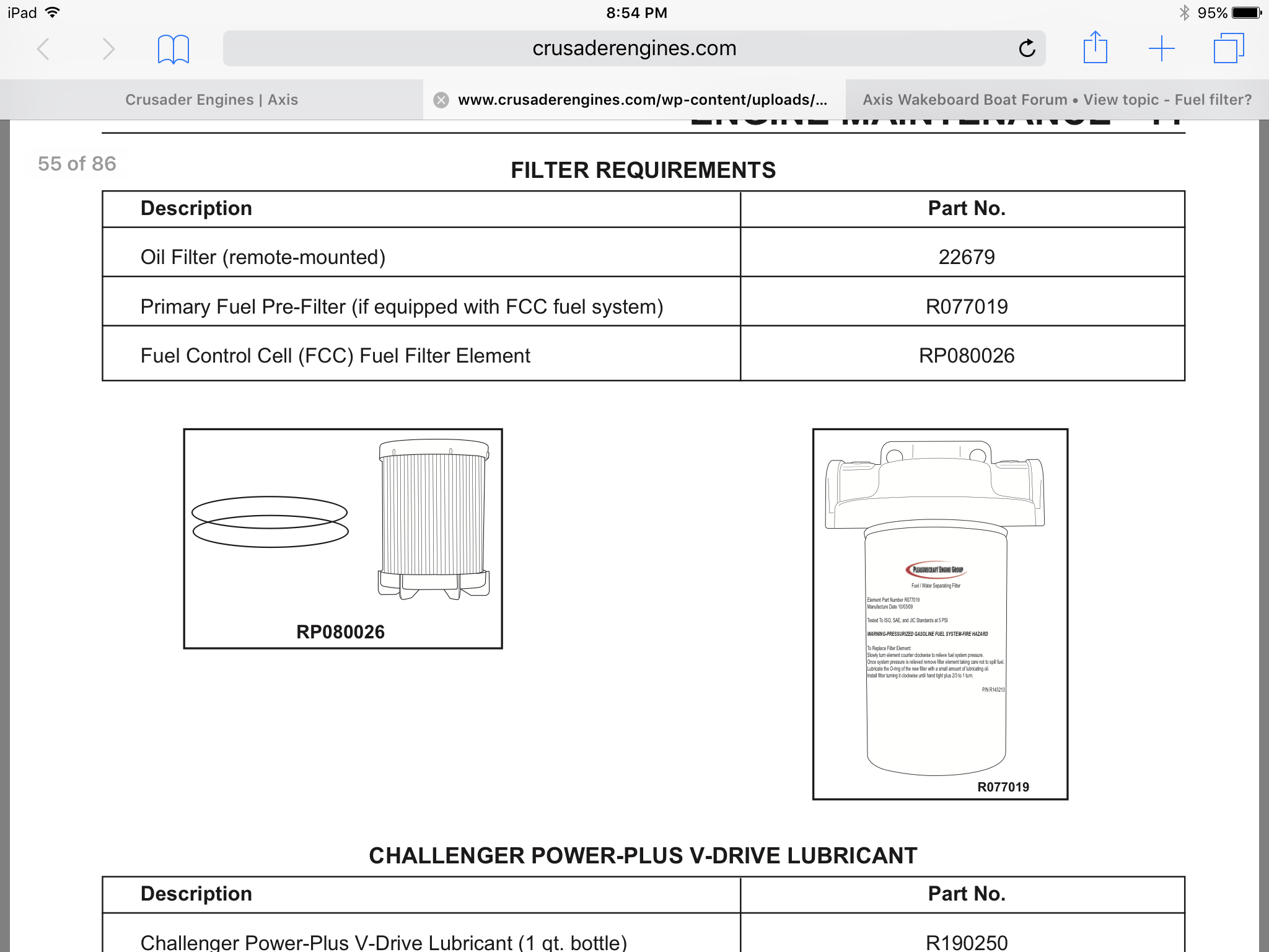

PostPosted: Thu Sep 07, 2017 11:31 pm
Joined: Sat Aug 12, 2017 3:04 pm
Posts: 41
See picture for oil fter fuel filter etc
2017 Axis T23 Red/Charcol, dual axle trailer, heater, chilax seating, flipping captains seat, sound pack 2, surfgate, and wedge. 850 sumos rear 675 bow
 Post subject: Re: Changing the oil
PostPosted: Fri Sep 08, 2017 8:56 am
Joined: Mon Sep 14, 2015 2:10 pm
Posts: 96
Location: Cincinnati
Your oil filter is a Napa Gold 1515, wix 51515, Royal Purple 30-8A or cross reference one of these.
