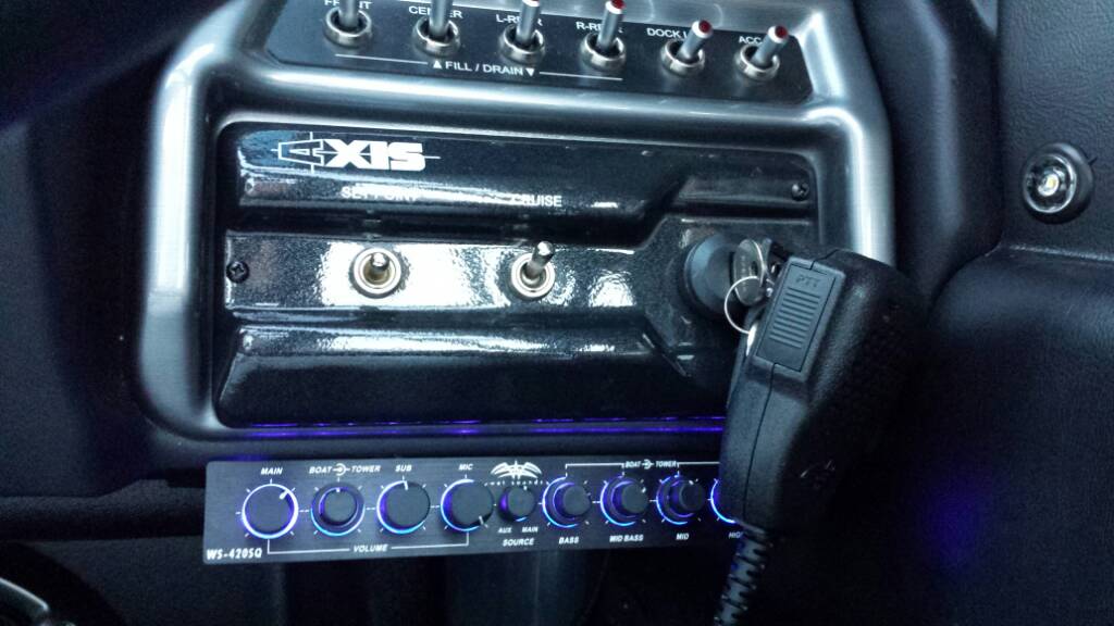

I didnt put mine under the head unit. If you decide to put yours under the toggles, i can talk you through it.
 Post subject: Re: WS 420 Install
PostPosted: Thu Nov 28, 2013 11:02 pm
Joined: Thu Jul 11, 2013 11:45 pm
Posts: 17
Here is what it looks like 2013 model a22

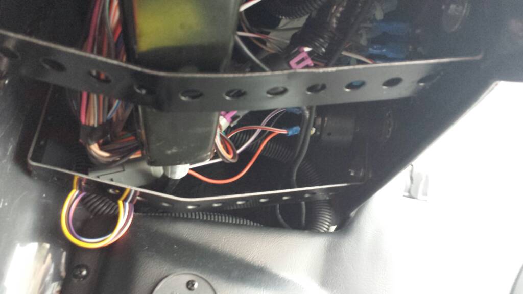

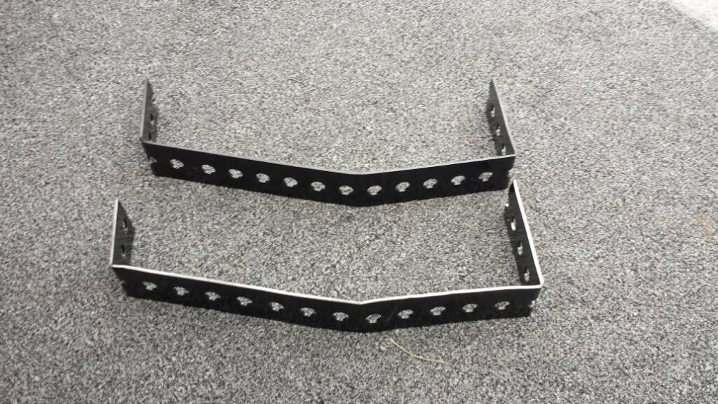

I made my brackets from some hangers that you can buy at lowes. You need some tin snips to cut them, fender washers and replace the two lower machine screws in the dash with longer ones.
