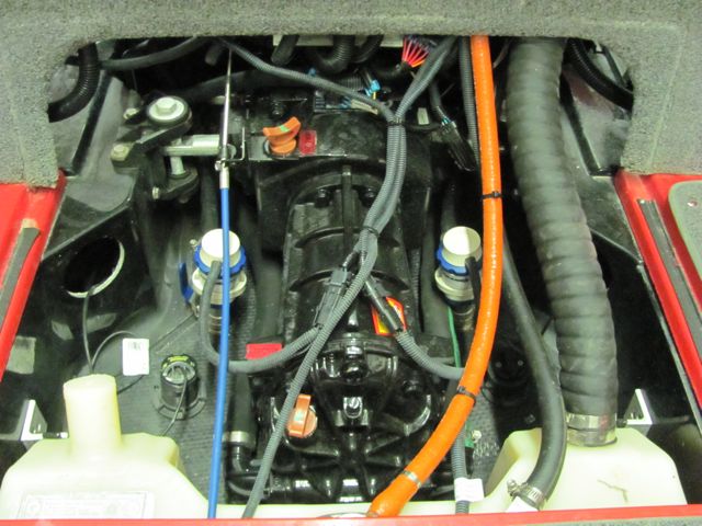

File comment: Start here, 90% of changing the seal will be done in this opening, If you have a prop puller now would be a good time to take it off, the shaft hangs down a little when you uncouple it from the flange, If not put a few towels between the prop and bottom of the boat so you don't scratch anything

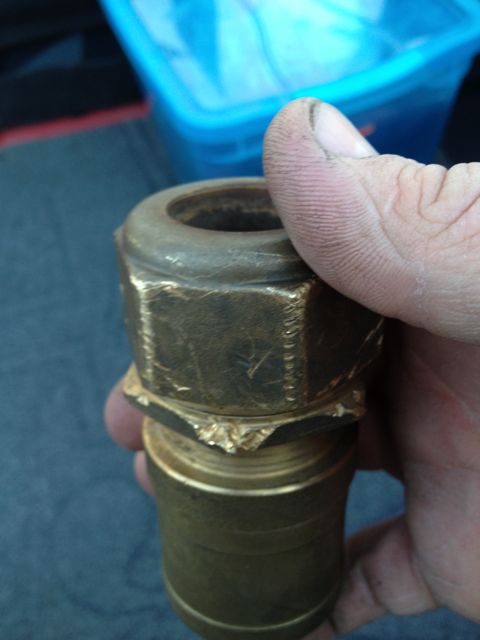

File comment: this is the housing for my original seal, you can see where the dealer got very rough with the jamb nut and used a freaking pair of channel lock pliers and a hammer and chisel on it instead of the proper tool.
