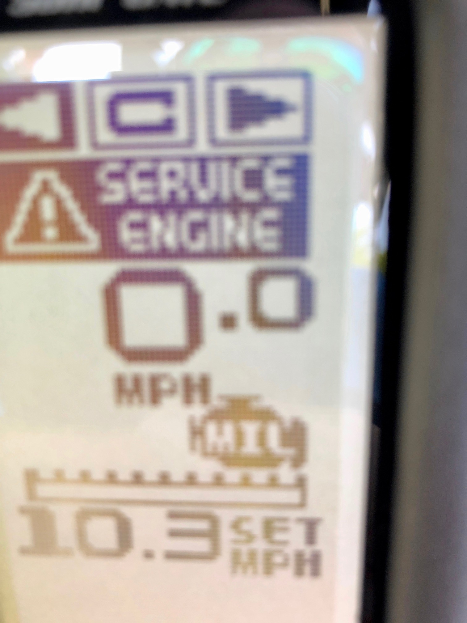

I hope the picture i attached shows up. Ran our '17 A20 all weekend without any issue. Monday morning I cranked it and the service engine light came on with a symbol that looks like some sort of pump with MIL written in it. I did the turn key five times to reset trick and it all went away. I was told if any gauges showed issues to stop use immediately. But it never came back and ran just great all day.
Anyone know what this symbol is? Thanks in advance.
54921021392__4E50FF47-050C-489C-992F-555E381B60E6.jpg [ 398.69 KiB | Viewed 24968 times ]

My 2017 a22 did this same thing with about 40 hours on it. It was a sensor throwing a code. 1 hour later boat started running chunky then would not run. Ended up being a bad injector.

can you go into the menus and see whether you have any stored codes? That's how you can chase down the "why" of the light.

I had the same thing on my boat first trip to havasu, wouldnt show in the code section of the menu either though on the day, shut down and killed the batteries and never came back again, reported it to original dealer and they couldn't replicate or find the code. In the search I did that day real fast online I came up with a loose 02 sensor. Hope that helps, one of the many ongoing random things my boat has done
