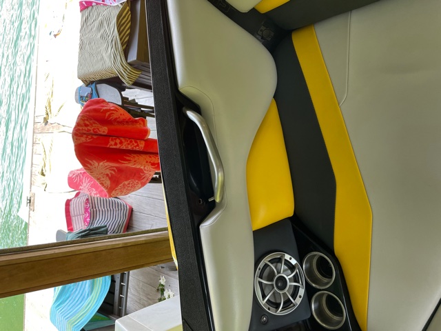

I have a 2015 Axis A22. The grab bar in the bow seating area on the starboard side has come loose. One end is totally missing a nut and the other end the nut must be loose. I can only figure the way to reach it is by removing a part of the upholstery directly below that grab bar. Has anyone done this that can give me advice?

You might be able to go through the cupholder holes. Might be too far away though.
In my 2014 A22 I can lift the center cushion and there’s a big hole underneath.
The upholstery is bolted from behind as well, so I guess removing that will be as difficult as reaching the grab handle.

Can you reach it by removing the speaker??
