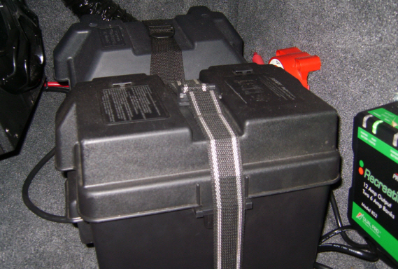

Posts: 10
We also went with an Interstate battery (SRM-27). Just used a battery box with a strap. We also added a prosport 12 dual bank battery charger. It's nice to be able to just plug it in at night and know the batteries will stay charged. Here is a pic.

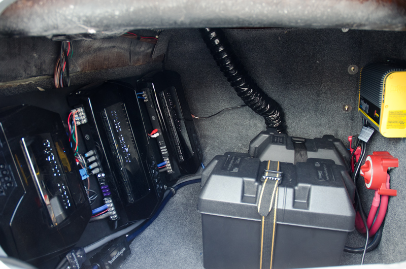

Posts: 106
Location: Wichita
Basically the same setup, different battery charger though.

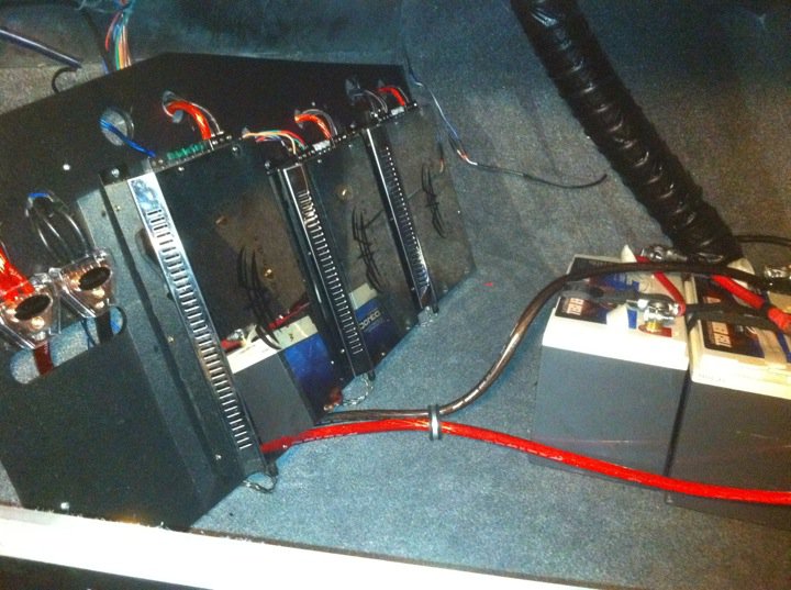

Posts: 168
I'm running two D3100's from http://www.4xspower.com. Love 'em.
